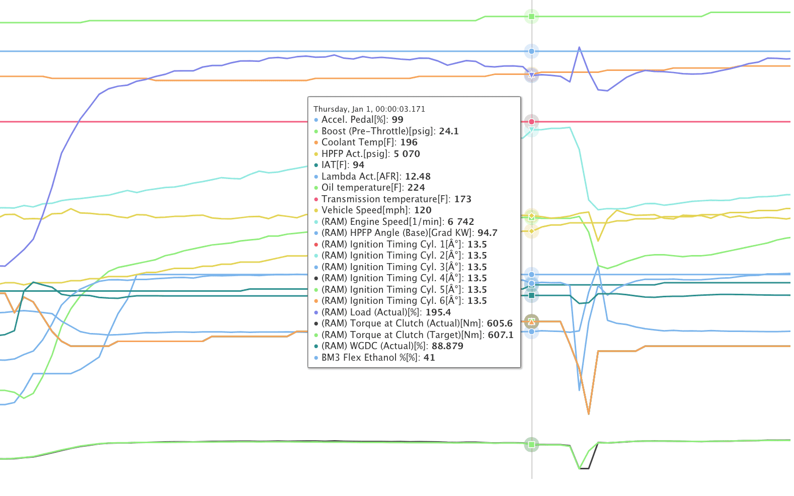

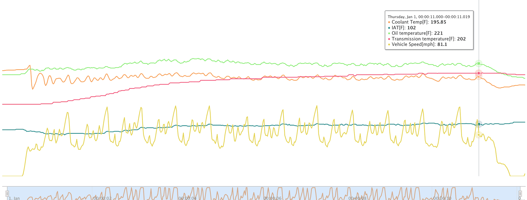

Here is from yesterday. I had some issues with the BM3 app not working so I had to reinstall and forgot to check ambient temp logging but according to weather app history it was around 65F ambient this session.
Also to note, I am back to self tuning the car this season. I have my coolant temp targets set lower as well. I am currently running about 24psi boost out the top of the RPM range.
This is my PB session, after 12 laps:
The PB lap:
Glimpse into the current state of tune:

Thanks Bryan. Love the data. 12 laps is legit test. The ambient was very low for a track day. The car must have been extra spicy. IATs are rock solid and very low. No signs of heat soak. I am sure you have some logs from last year. Once you get some apples to apples comparisons it would be nice to know if there was any gain. Obviously this won’t be a great indicator of a potential benefit for us stock guys but a benefit would show ducting does something.
