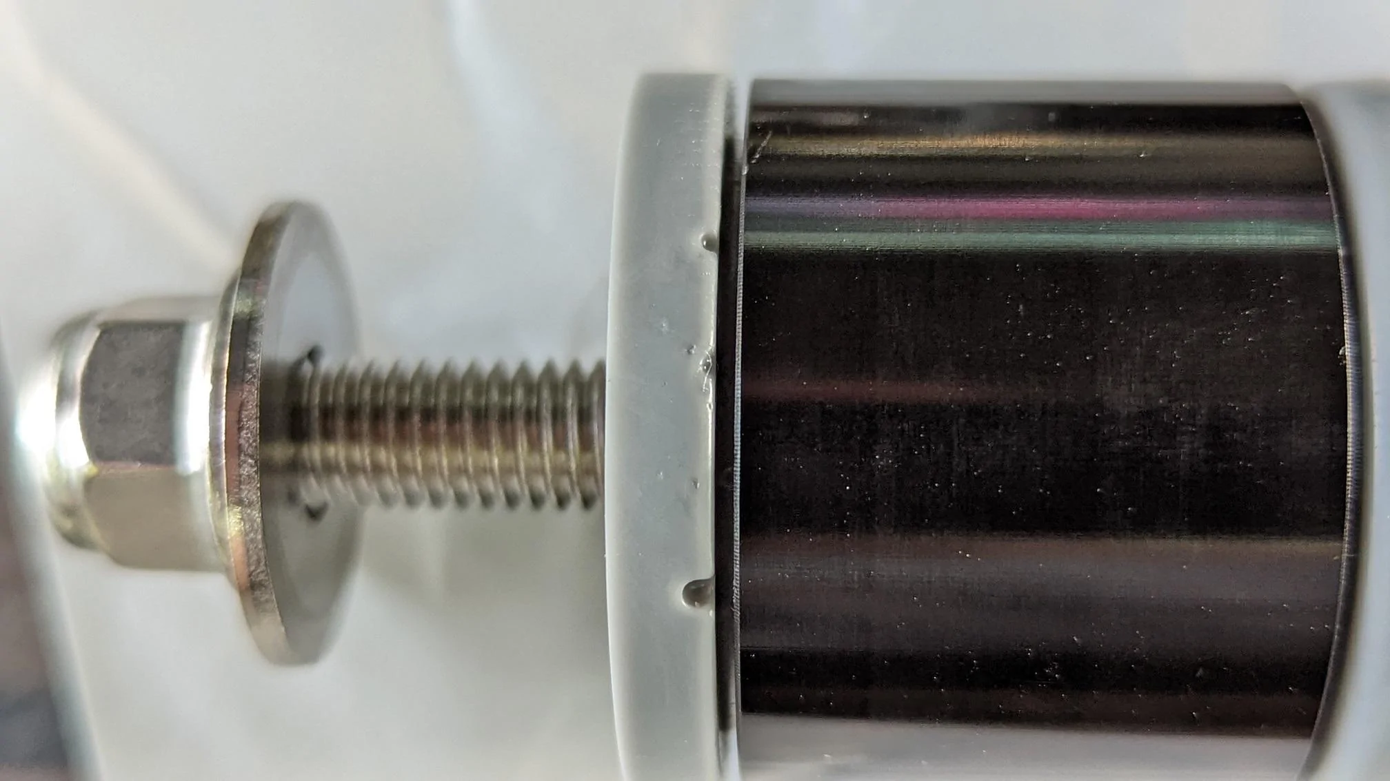

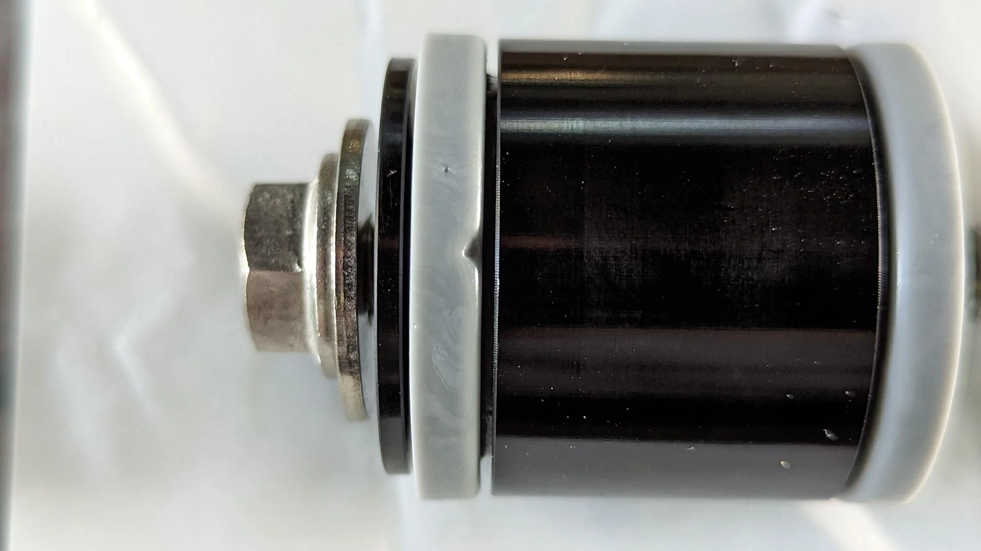

Instead of creating a new thread I figured I would revive this one. I purchased and received the "upgraded" version of these transmission mounts this past week. They are scheduled to be installed the beginning of July. I noticed the below imperfections on the product when I received them:
I reached out to Justin and he said it appeared to be a mold issue, which I agree with, and I should be good to go to install them. I'm worried about these imperfections leading to cracking in the future, especially since I'll be repeatedly be loading these up on the track. For those who have the product, did your mounts look like this? Have any issues? What are other's opinions on this? I can't say I've ever received any bushings or mounts with these kinds of imperfections before for other vehicles. I'm not throwing shade their way, they've been great do work with, just want to get it sorted and need some input from the community.
