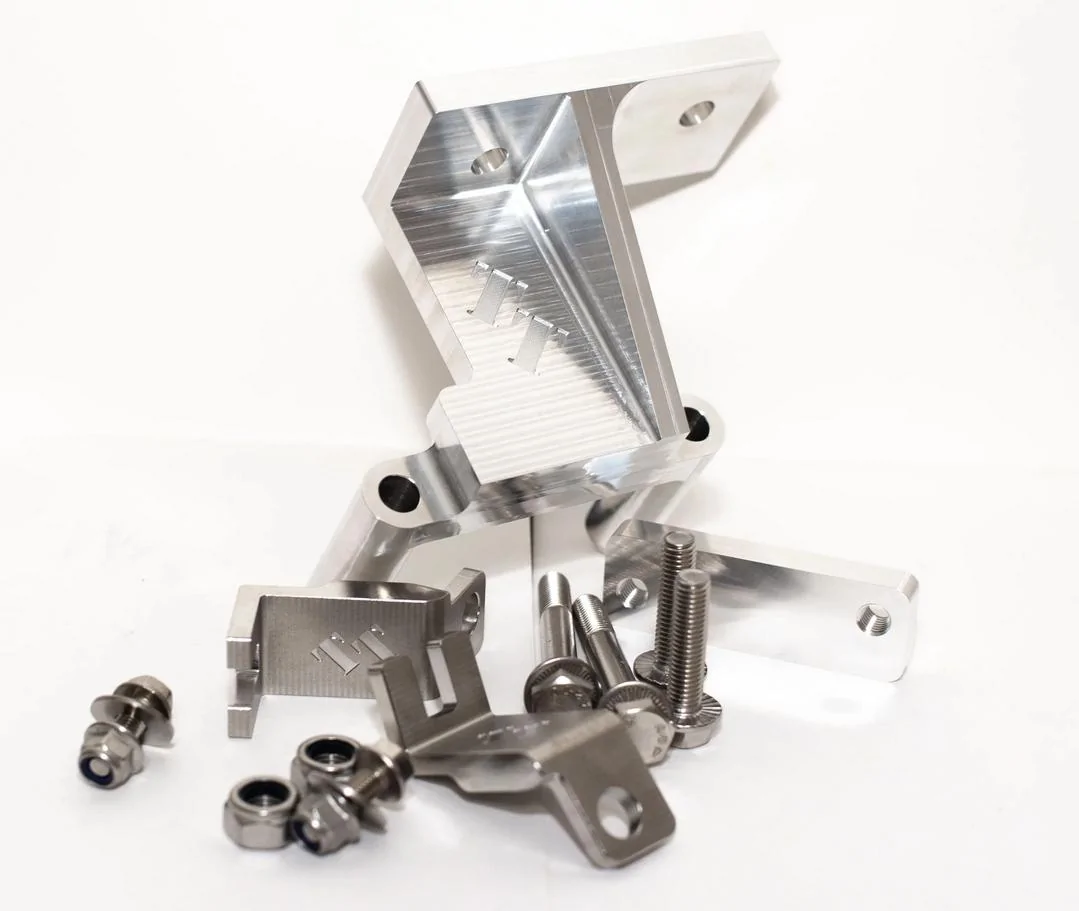

I wouldn't bother with the headache of replacing the mounts for solid. Best option is our diff bracing kit....
https://twistedtuning.com/products/...1&_sid=0fe651bd5&_ss=r&variant=40961308164144
Easy install, easily reversible and also lock down the pass. Side of the diff which still moves a bit with the solid bushings due to the rear mount placement.
your kit looks amazing
we even talked before, the reason i didnt buy it is because i have the verus cooling diff plate and i dont know if it can be installed together.
also i dont know if i need only the front braces or the rear also, the price difference between them is substantial.
