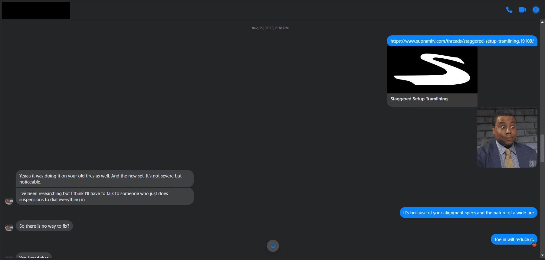

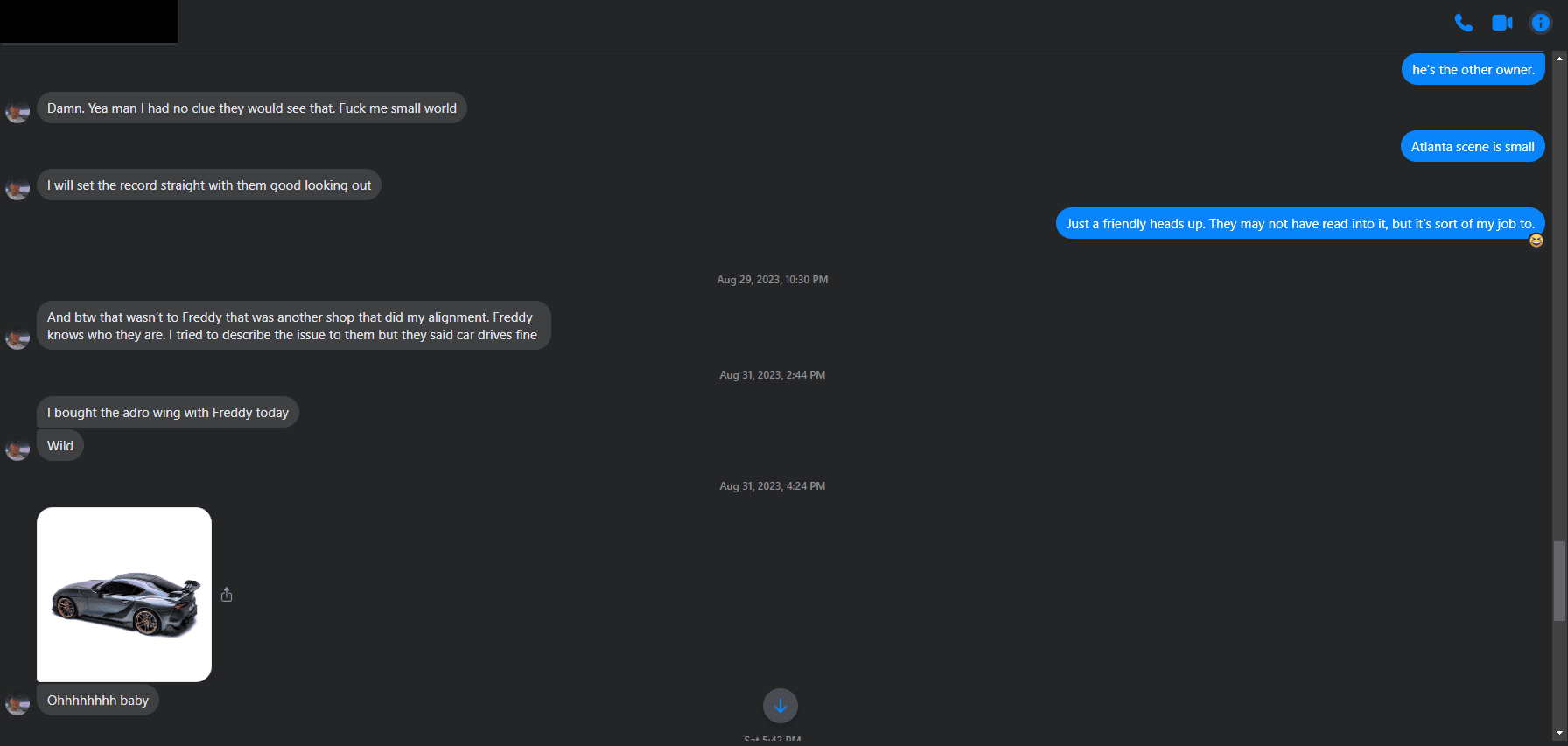

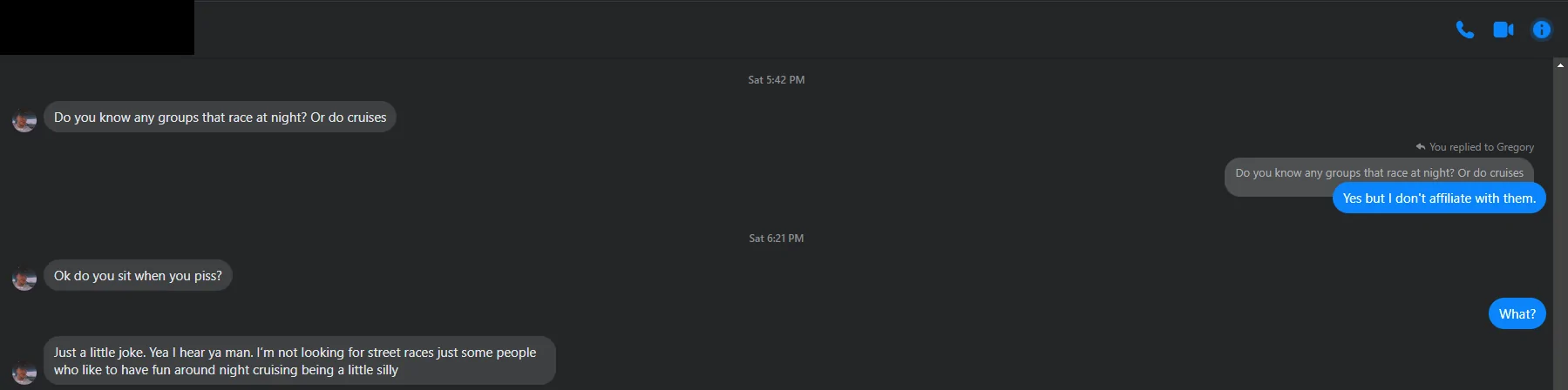

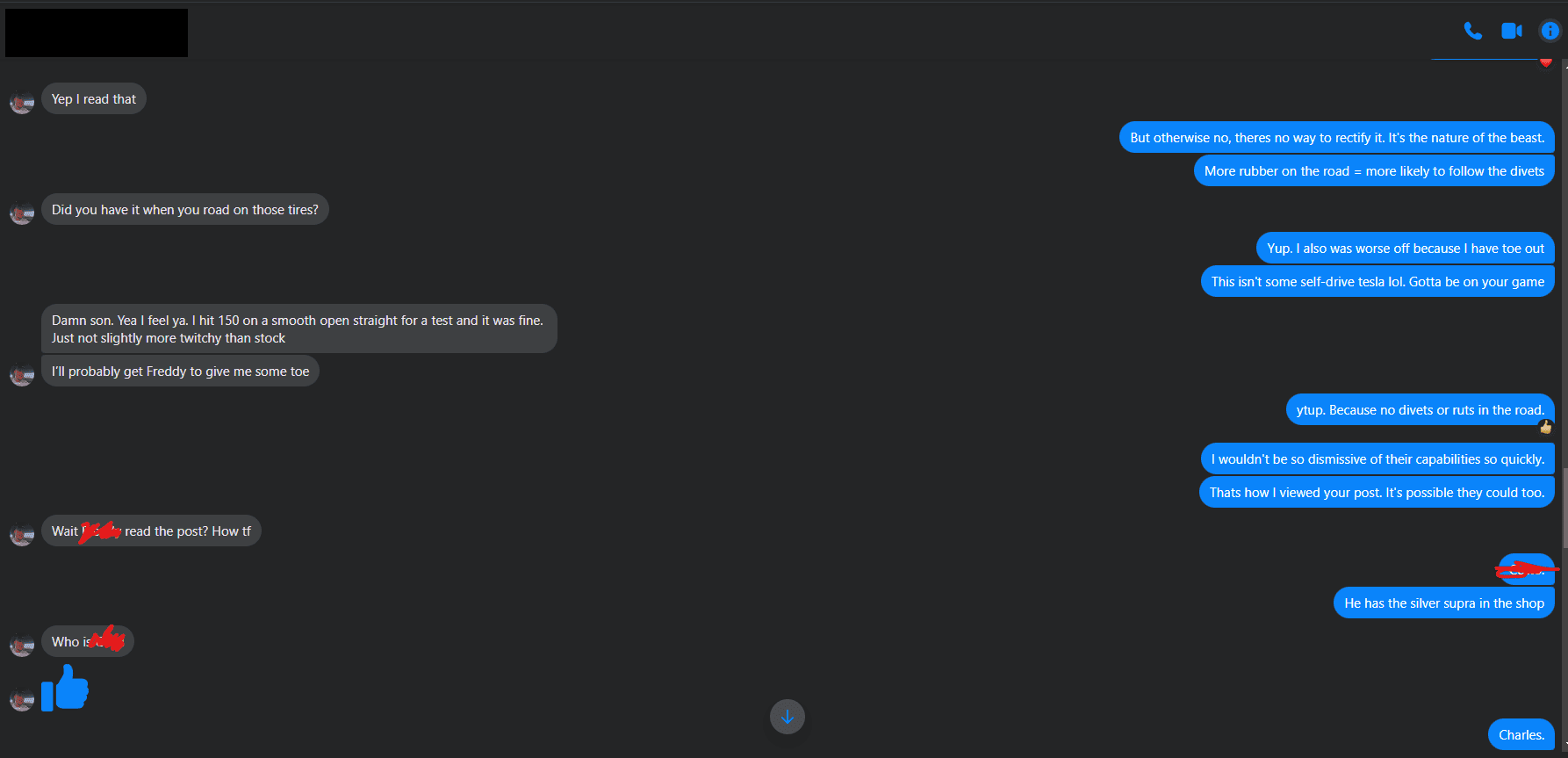

So instead of talking to me, you'd rather post like this on the forum?
I didn't "go behind your back"
I have a very good relationship with the shop you kept talking about having work done by. So I reached out to see if there was something that was missed or that I could help with, considering 80% of my day consists of sitting at a desk doing nothing but research.
Nowhere in yours and I's conversations was there even a mention of another alignment shop having done the work (Considering I only recommended two shops and I know for a fact one hadn't gotten booked by you for an alignment) until the end of the conversation.
I'll post up the entire conversation since you want to go at it like this.,
