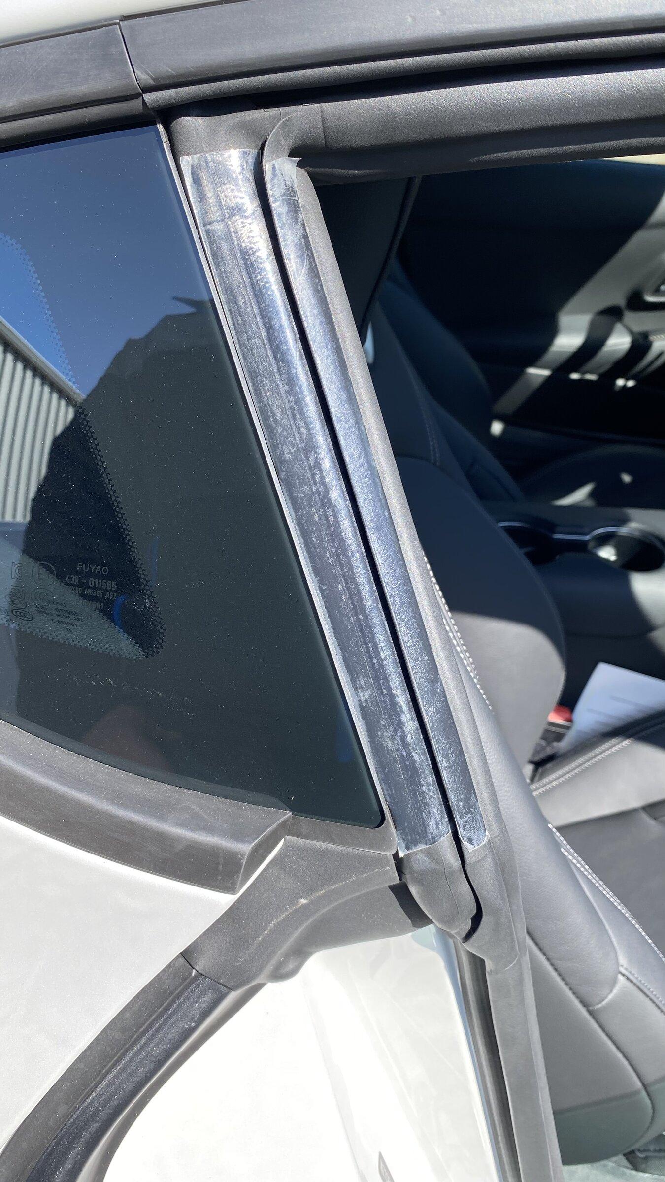

I had the same issue and thought it was something near there as well....but since I had sound deadened the entire car and got rid of all the metal clips that make noise, I knew it had to be something else. I had tried a million different things in the door thinking it was the plastic trim on the door panel or the lock mechanism moving around. Eventually I figured out it was the window glass rubbing on the rubber seal....when I put the window down, the noise would go away. I tried lube on the seal at first but that didn’t work, so I ended up using this anti-friction tape..... I put in on the rubber seal between the glass and the door jam. It doesnt look the prettiest and needs to be redone every 4-5 months...but its affective. Hopefully that helps.
Anti-friction Tape

Yea I tried some of that too…didn’t work for me. I tried Gummi Pfledge (or however you spell it), Sailkote, Shinetsu grease (Honda lube) and nothing permanently fixed the noise until I applied the tape.
