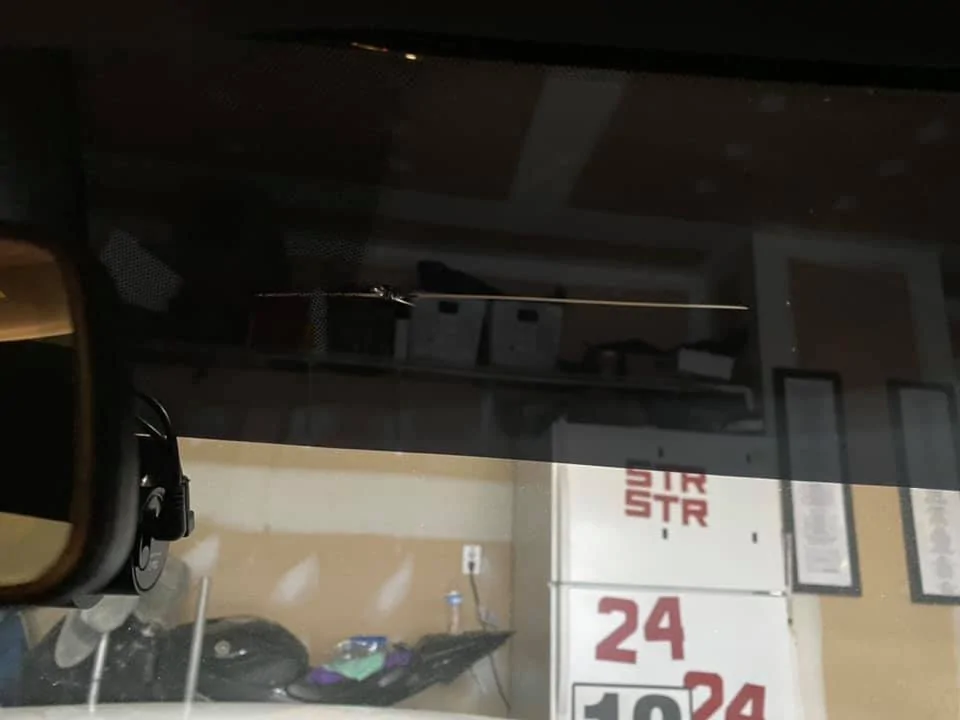

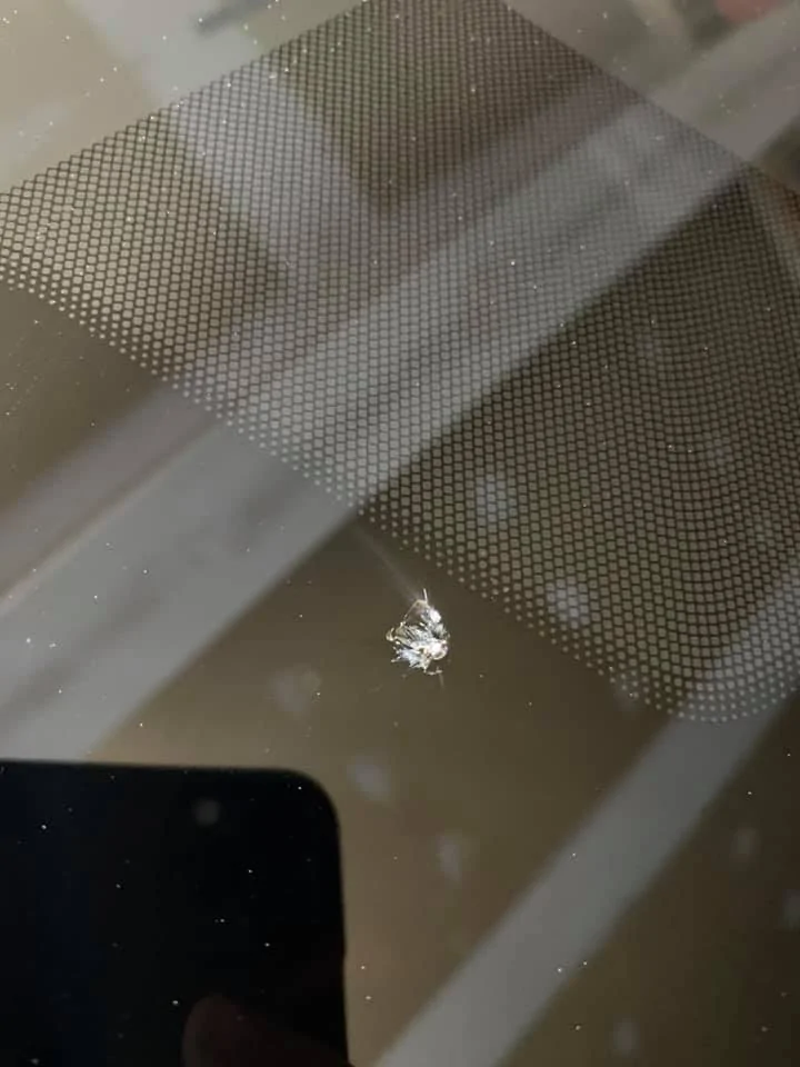

Has anyone had their windshield replaced yet? I got a chip while driving yesterday from a rock, had an appt at 8am this morning to get it filled and when I woke up it was already cracked going both directions. They tried to fill it away but was unsuccessful.
Wondering how much it cost to have the windshield replaced, and sensor re-calibrated for the cameras?

Would like to know as well, got a crack myself going almost across the whole width of the windshield, it started like your and in a very similar spot but the crack kept growing by the days so watch out for that,I don't think it's possible to stop it at this point. BTW I tried using a windshield crack repair kit on it but it helped a little to hide the crack line itself but didn't end up fixing it completely or stopping it from growing
And in my country at least I think they estimated ~6 months for me to get a new windshield from Toyota :eek:
I am considering covering the upper portion of the windshield with a black wrap from the outside like MANHART did with their supra to help hide the crack till I eventually get a new one installed
But am really disappointed with the rigidity of the supra windscreen, I believe it's easily crackable as many supra owners has reported and would be an apparent issue like the Mustangs from what I read

Quote from the dealer was about $1,400! That is new OEM glass, rain sensor, install and calibration of the camera/radar at the top of the window. Good thing insurance deductible is less than that. They said it will be 2-3 days and the glass will be in.
