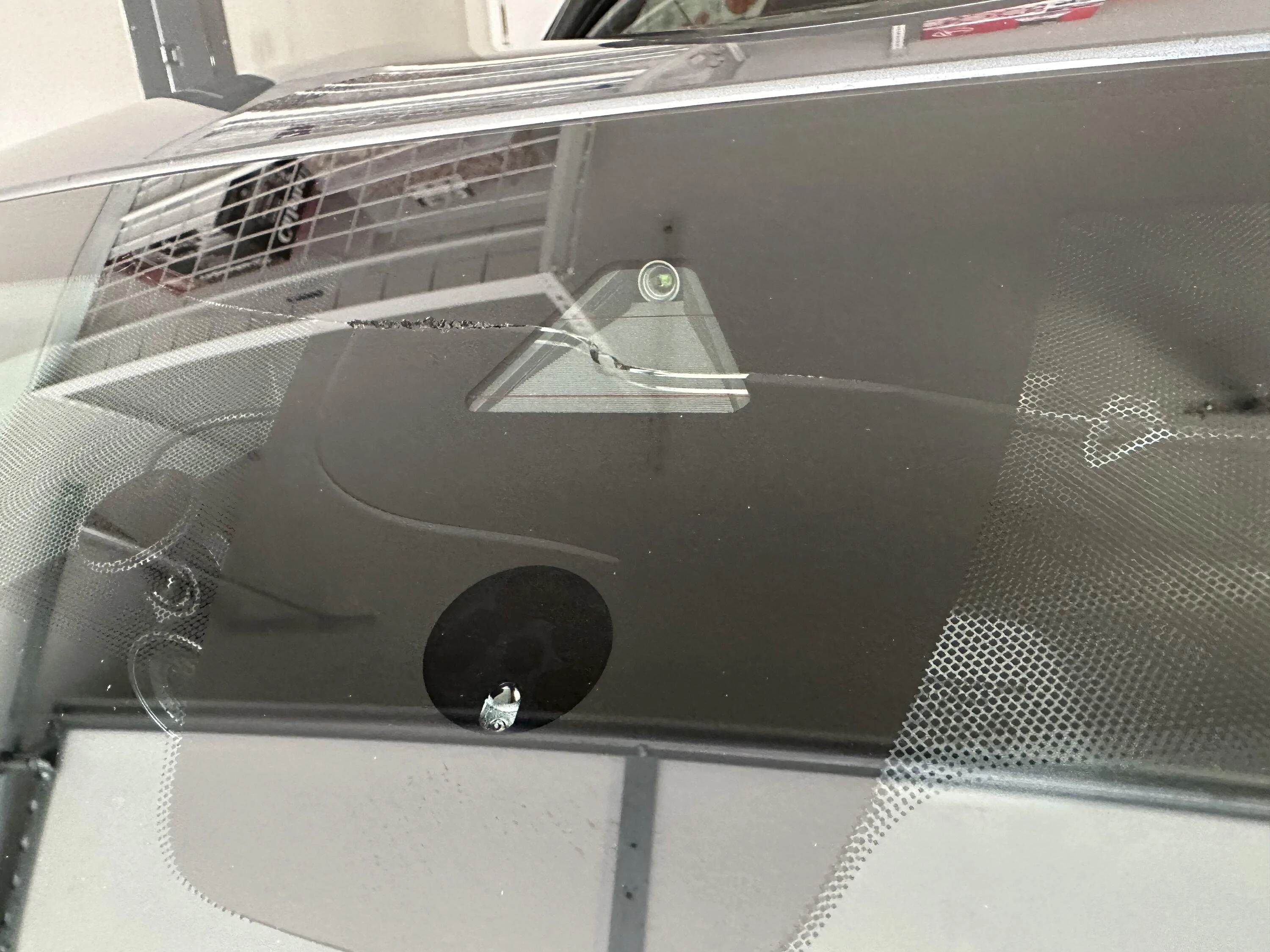

I’m now in the “windshield club” after a drive on I-285 in ATL last week! Safelight quoted $1500 full replacement including calibration.

Happened to me. Paper thin windshield smfh
