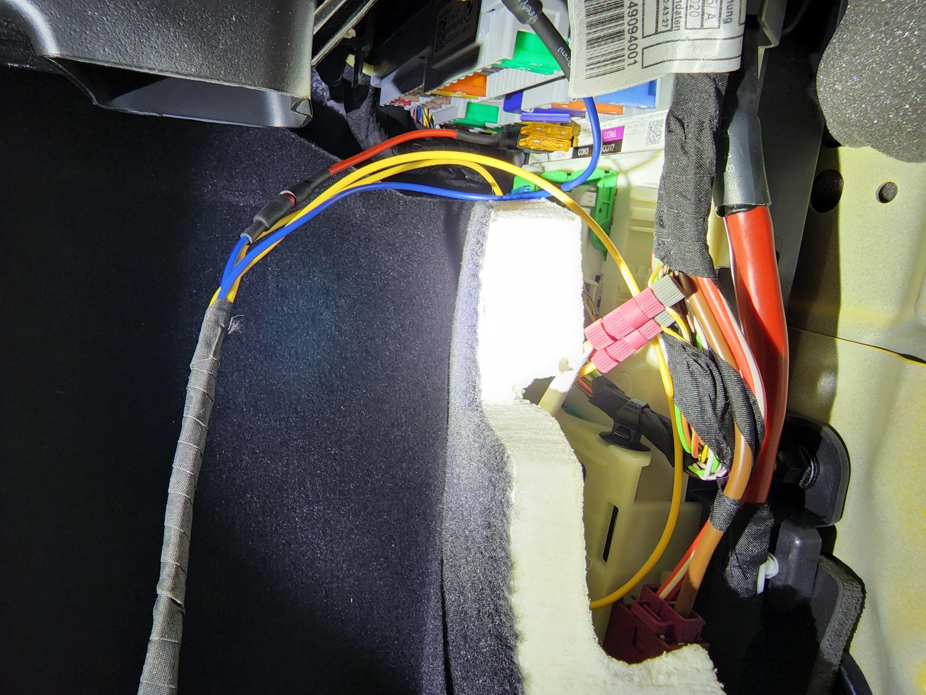

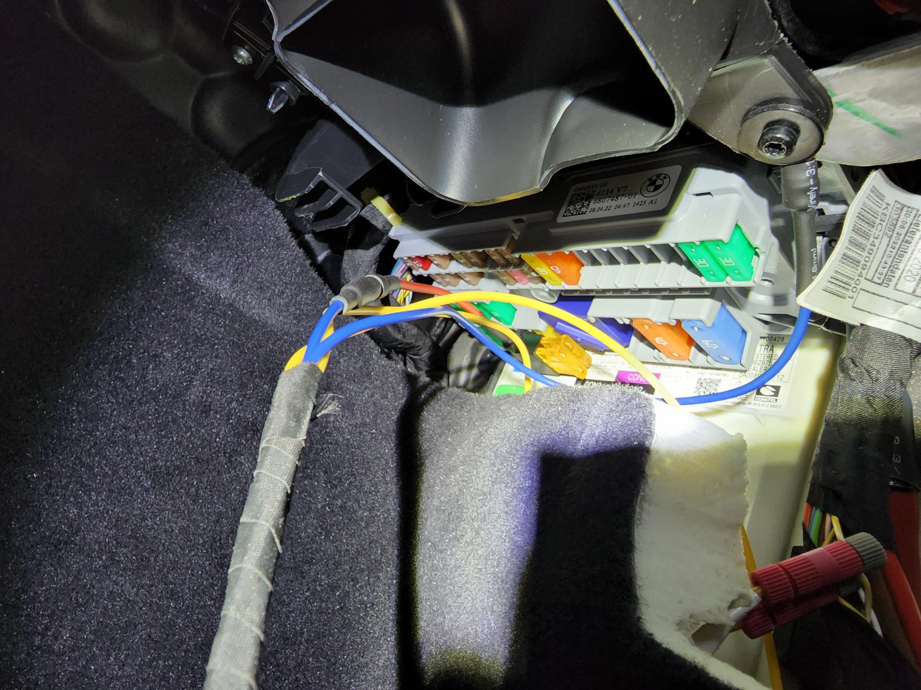

Hey guys, just got my Supra last week and its awesome! I'm going to be gradually transitioning it to a dedicated race car, which will require data collection. My data logger and display of choice is the AIM MXm. See below for how to connect to the ECU/CAN bus.
Above you can see the Fuse tap in F47, which is an empty slot that comes on with door open and is depowered 6 minutes after shutdown. I am still debating whether or not to put a switch inline for greater control. You can see my ground wire up top under the plastic trim.
Find the ECU/CAN bus wires near the BCM, will be a yellow/white (CAN high) and yellow/black (CAN low). I used PosiTaps to connect these to my custom harness.

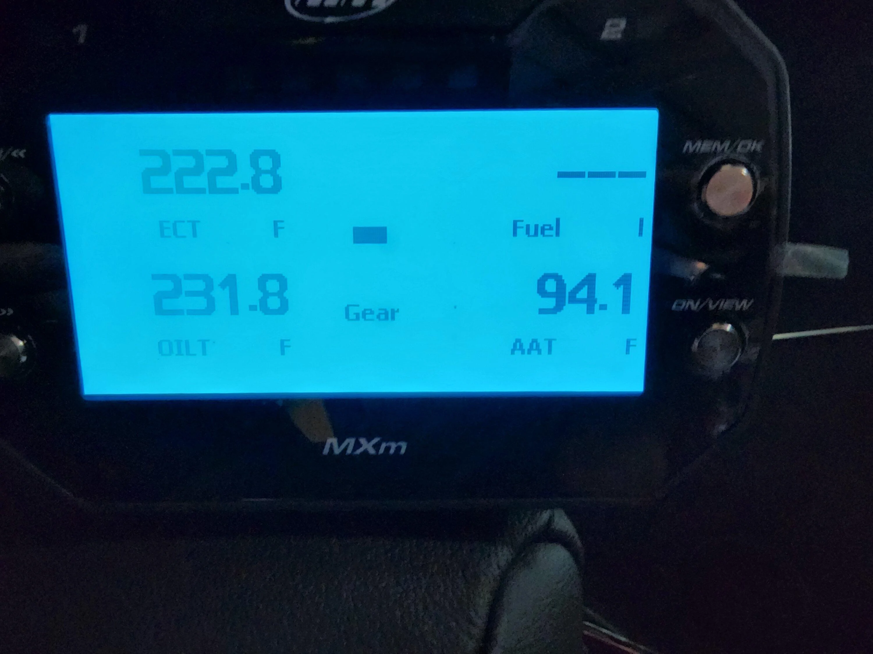

Now we have power and data flowing to the MXm! Now I just need to figure out how to mount it........

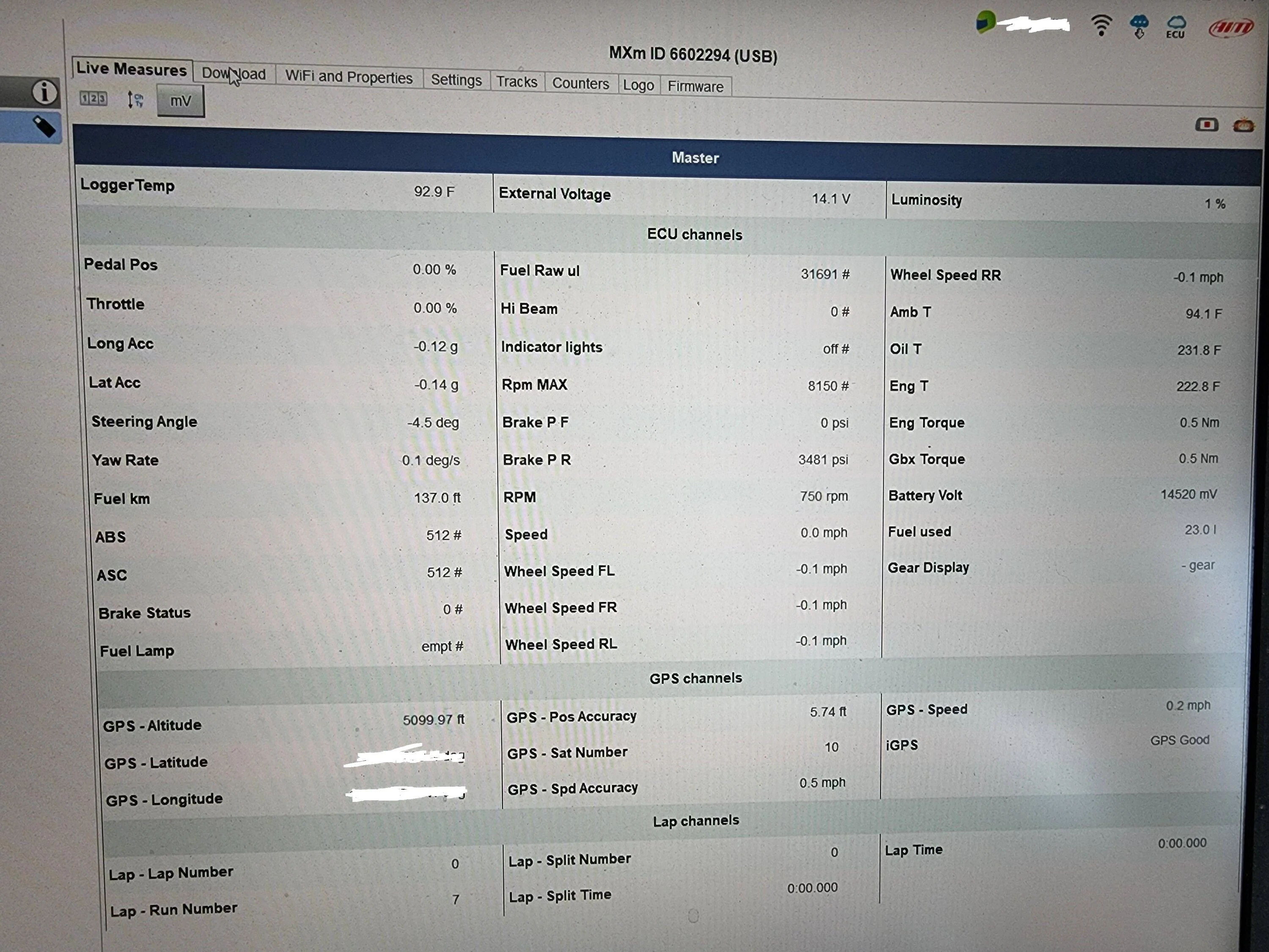

Full data display on my PC, all the available data values are represented here. Unfortunately, there are a couple of values available through the OBDII port that are not available through the ECU. IAT being one. Will have to sort that out, maybe with an expansion port.

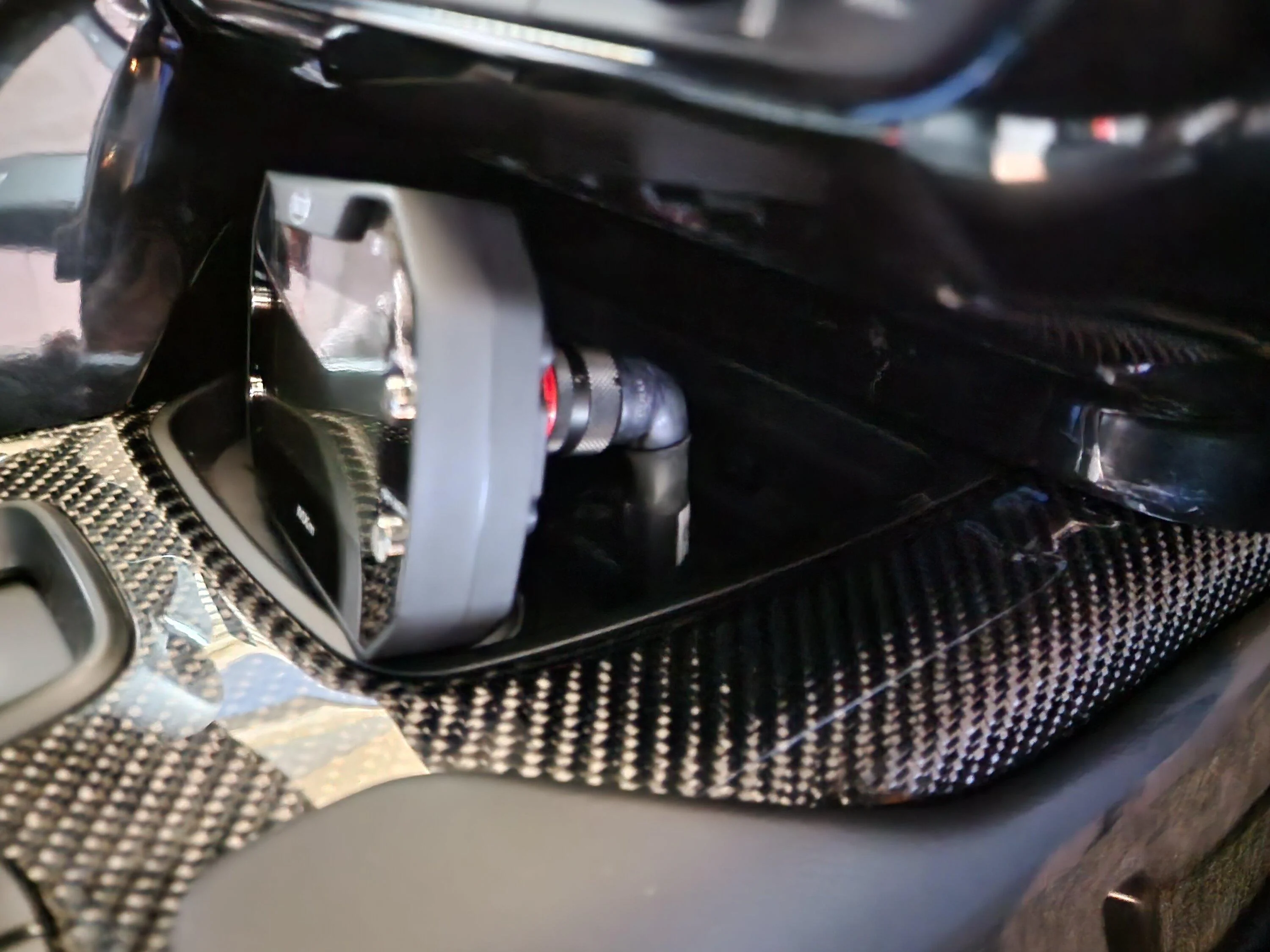

UPDATE!
Ok, if you remove the console piece that contains the wireless charger/USB/12v, there is tunnel access to the rear where you can feed your wires. Worked great after some finagling to get it through. I removed the wireless charger and drilled a hole where the charger used to be.
Its pretty solid as it, but will fab up some kind of mount in the future. Just happy I was able to make it look neat and tidy.

I did not, but things have been on hold for a bit since I moved across country. Will get back on this soon. I did confirm that the AIM MxM cannot take two data streams at once, unfortunately.
I spoke with Jaden at aimsports, he said IAT should be available from the CAN. Heā€™s going to check their ecu programming for the Supra and try to get it added. So keep an eye out for any updates. Your current configuration should pull it if they get the programming sorted.
