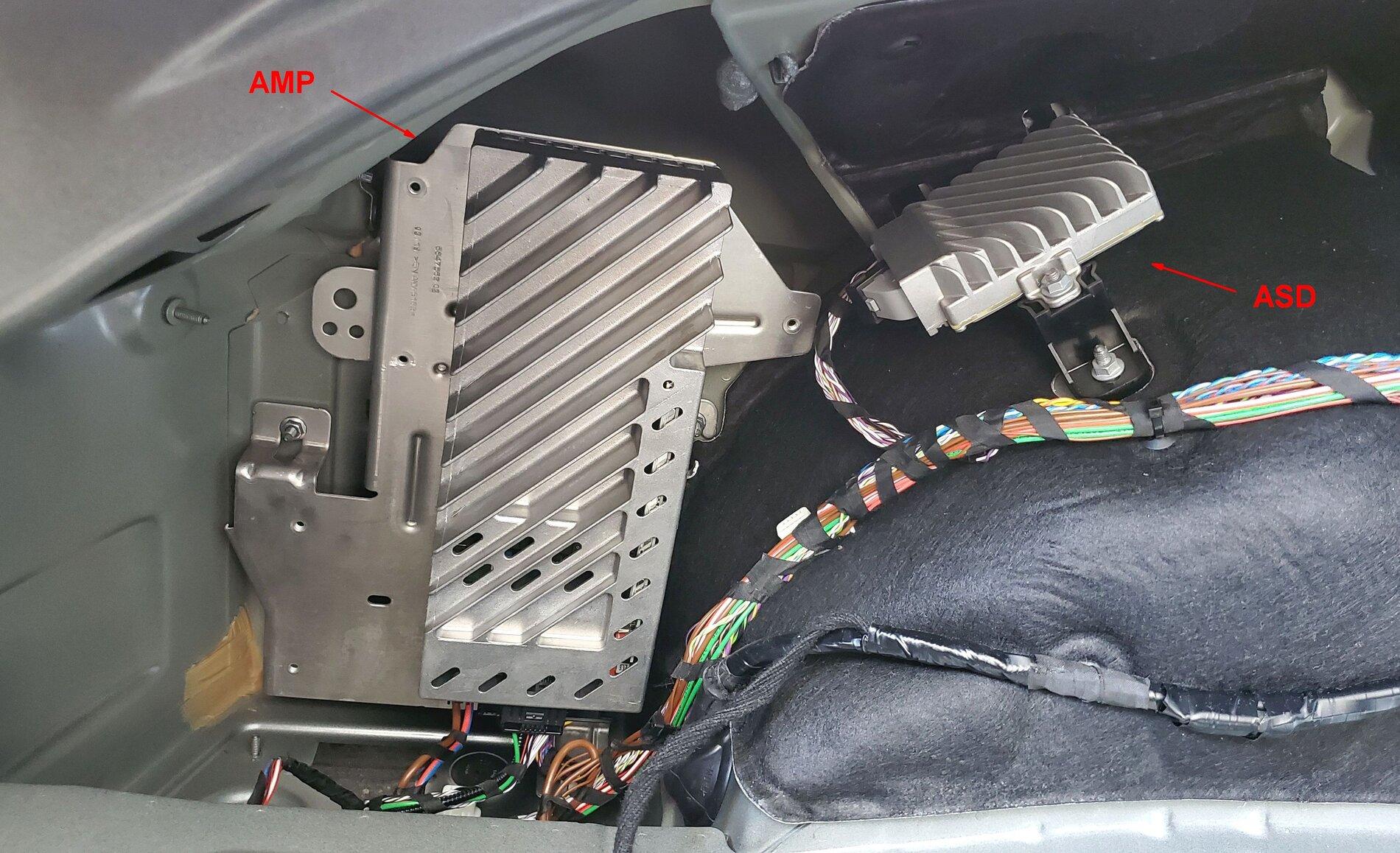

The dynamite that you linked is that only enough to cover the floor?
I wanted to see behind the side panels to see if I should apply any there.
Actually there is fairly thick padding applied behind those lower side panels as you can see off to the lower right in the pic below....

Ok good to know I shall save my time and apply to trunk floor.

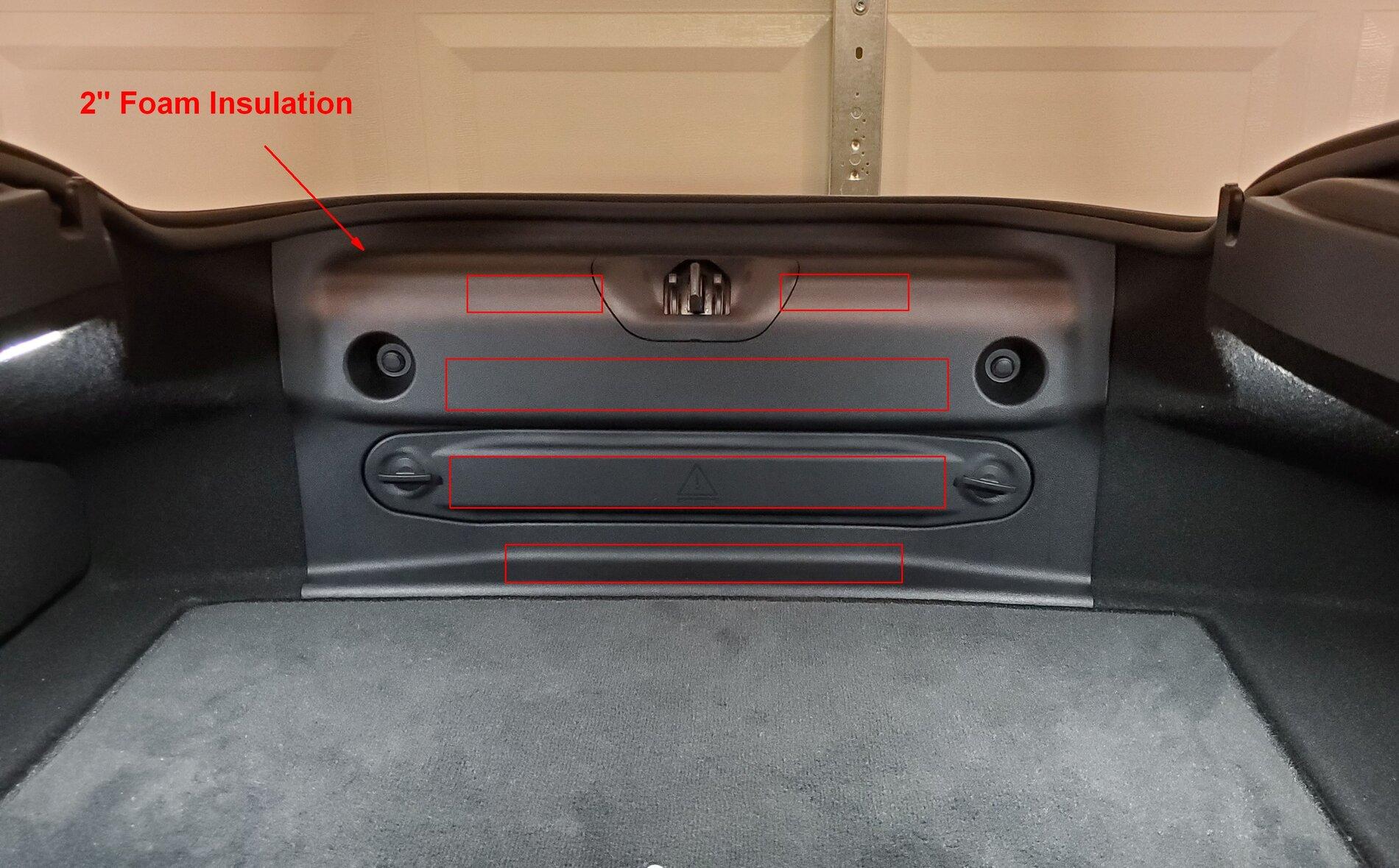

Now behind the rear panel could definitely use some dynamat...note the pic says foam insulation but I changed that out and applied dynamat strips to the areas highlighted below

So apply dynamat ILO foam directly on the metal sheeting not on the plastic. I also ordered the NOICO.
I applied the dynamat directly to the back of that panel...
Does it still work effectively. I always assumed it needs to be applied directly on the vehicles metal sheeting.
I wouldn't have done so if it wasn't effective..ha! It's not the sheet metal that's the issue..It's the thin plastic cover that tends to vibrate a bit during very deep bass notes...this resolves that problem...
