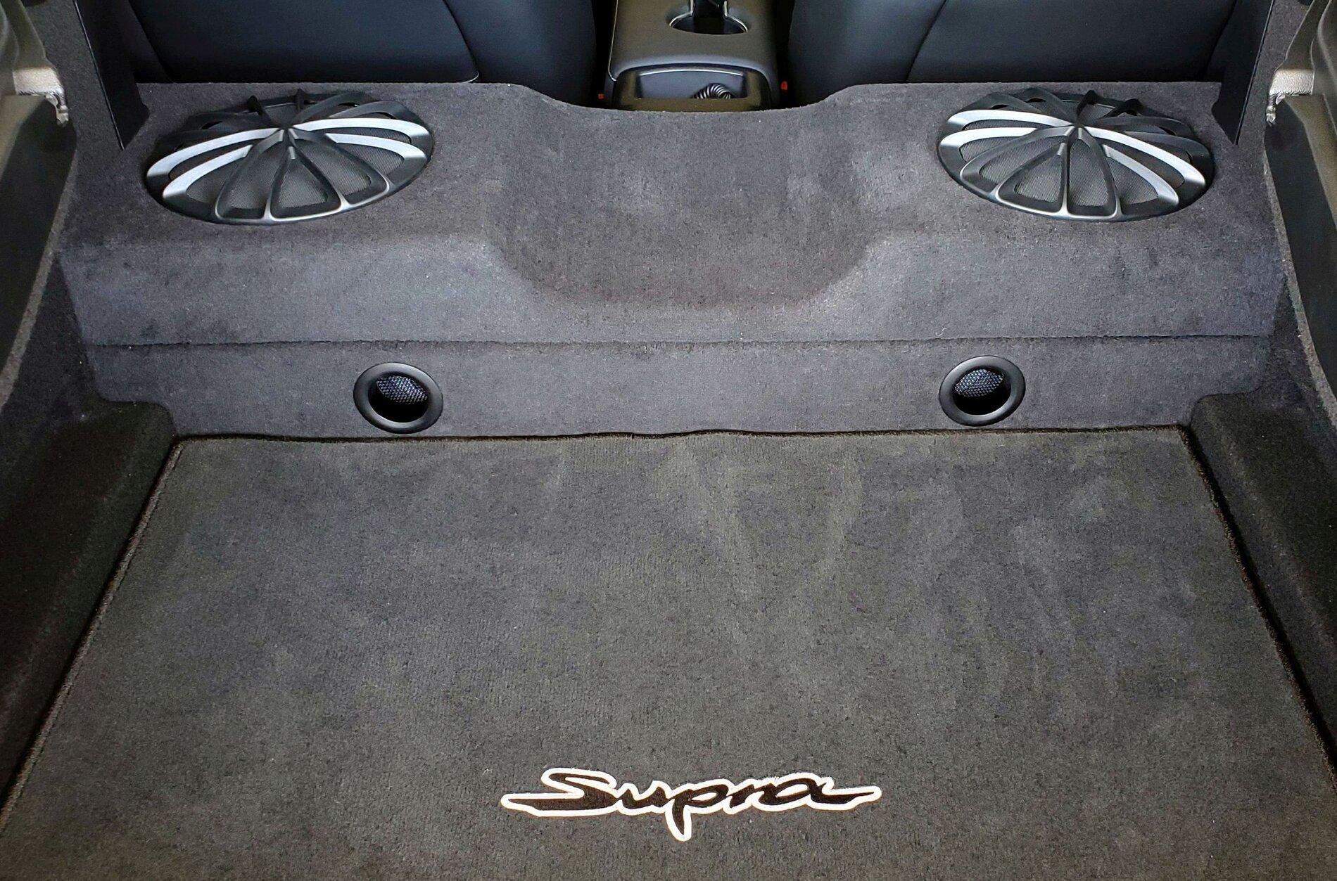

Yesterday, I was driving home from a trip to BJs and my trunk was completely full. Listening to the same music I always listen to, I had to turn around and see if I was in a different car. The sound system was perfect; bass tight, and zero vibrations. So, this week I will be making the same adjustments here in the thread because the system is certainly capable with the right sound deadening enhancements!

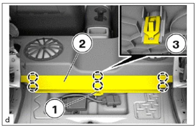

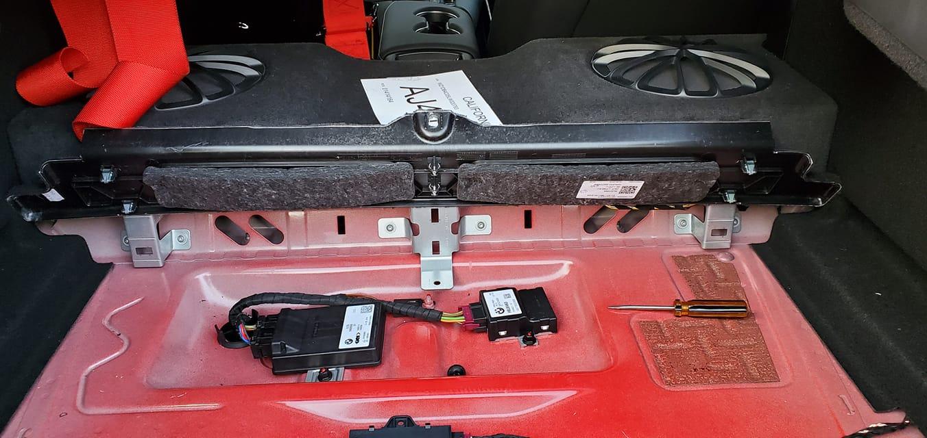

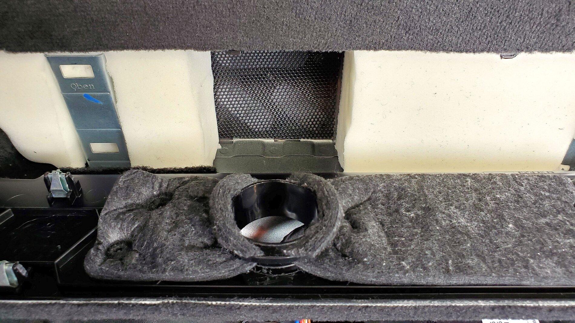

Actually, It's more than sound deadening that needed to really make significant improvements to the OE system's bass quality...
The primary reason for the poor OE bass quality is that a narrow rear panel was placed directly over / in front of the OE exhaust ports as I explain in my original post...This design flaw alone contributes to roughly 90% of the poor OE bass response quality...Simply removing that obstruction by installing ports on the rear cover panel is where the greatest improvement to overall bass response and sound quality is achieved...
That said, the additional sound deadening does help quite a bit with enclosure and rear cargo area vibrations as well as reducing road noise....

Try taking off the panel labled "2" in tadda's post for a few days, you will shit your pants

No, I totally agree with you. The absence of the exhaust ports is certainly evident, and completely agree. I will be making this modification as well. Just stating that the bare minimum of getting rid of the rattles (by filling the trunk) noticably improved the quality.

In the mean time I suggest simply removing the narrow rear panel which alone will make a very noticeable improvement to bass quality...
