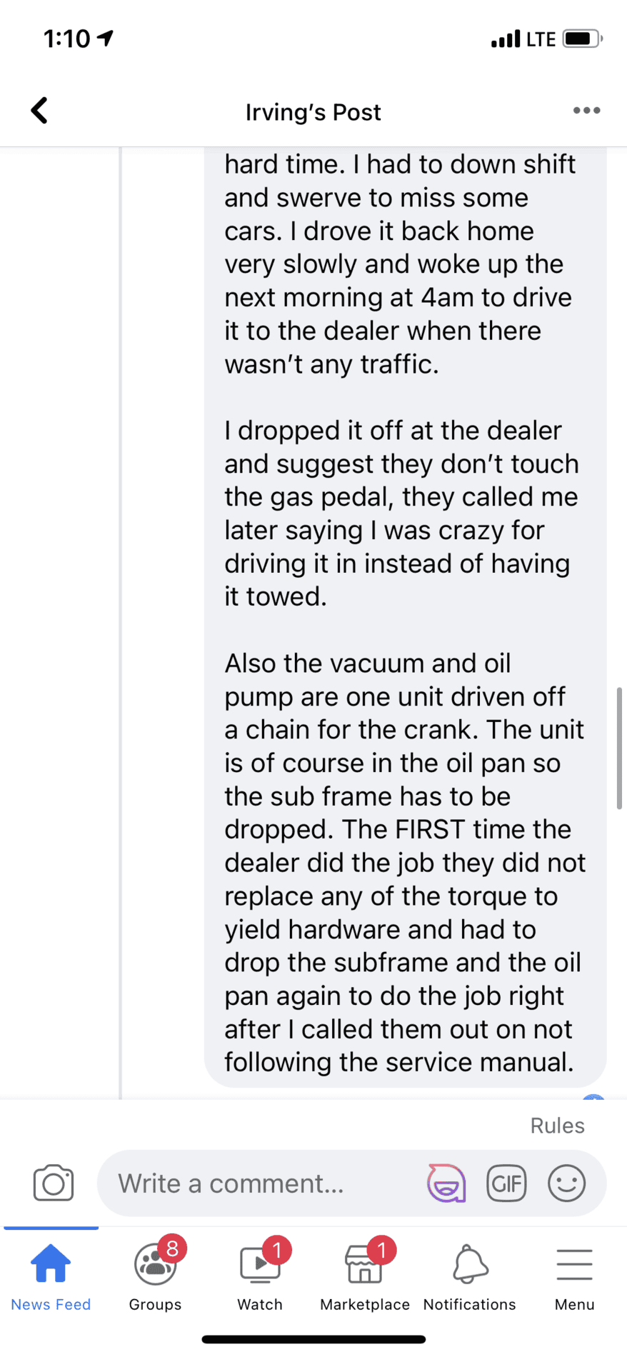

i believe one guy on the facebook page said he had to get his booster fixed and it was a pain in the ass.
Been so long since I've logged into FB.. Curious to know the man-hours that went in and what got replaced..
