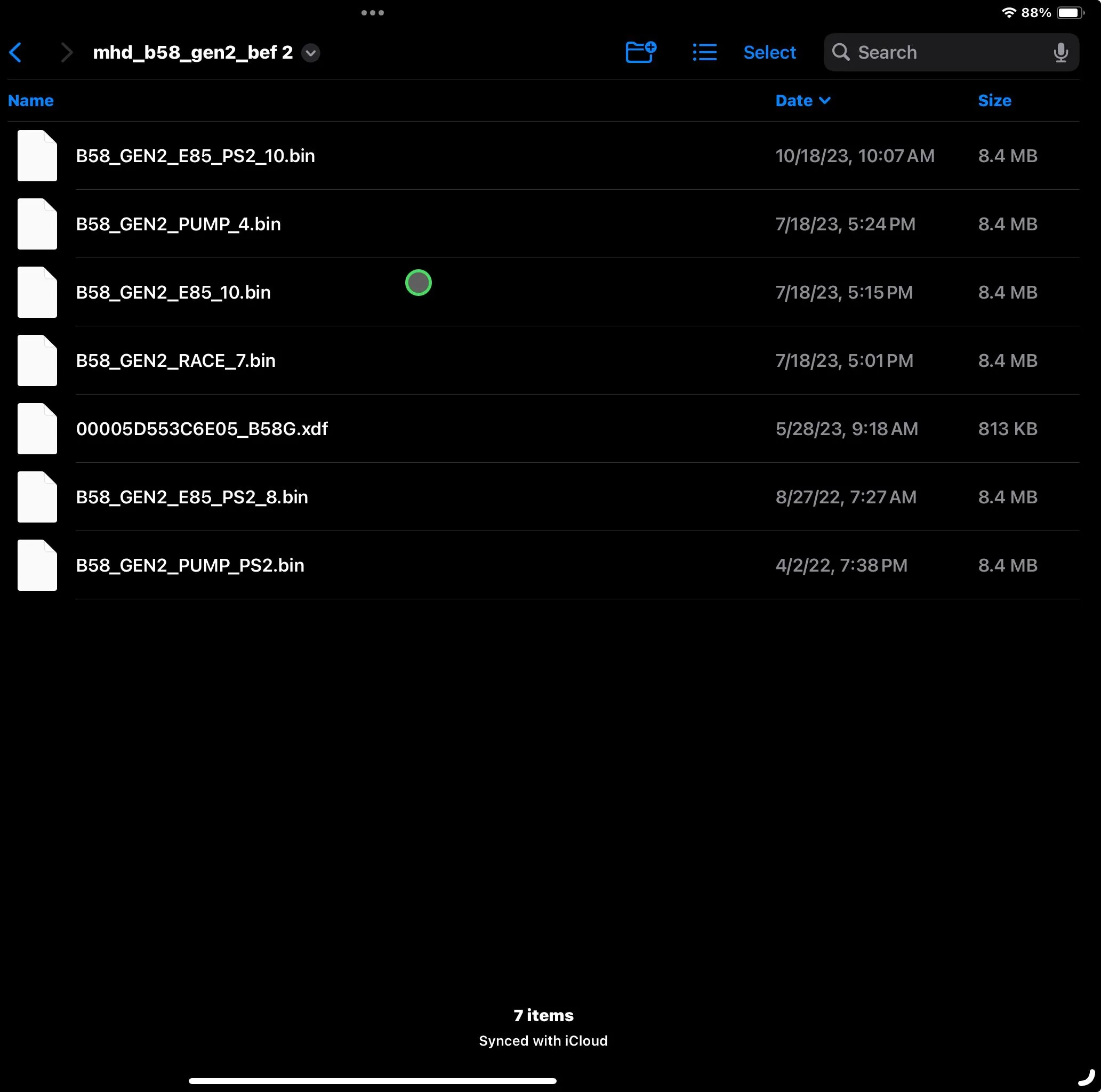

This is why it’s confusing: Here is what the B58 Thread says for instructions:
RACE: Intended for most applications including good pump gas fuel like 93 octane up through 30% E85 mixtures, can also be used with WMI.
PUMP: Intended for lower grade fuels such as 91 octane or in applications where less overall timing advance is needed than RACE. PUMP_91 is for very low grade fuel like 89-91 octane.
E40-E60: Intended for most E85 mixtures.
STRAIGHT-85: Intended for those customers running 100% E85 generally in conjunction with the an upgraded high pressure fuel pump like Fuel-IT or Dorsch.
WMI: Indicates a decaying fuel scalar for vehicles equipped with higher volume WMI or CPI systems.
PURE/TURBO: Indicates mapping intended for use with PS2 and other larger turbo options.
But if you look at the attachment below for the actual maps in the folder it doesn’t line up. The only one is Race that lines up with there descriptions And it doesn’t work LOL

Oh that is good to note. I just went back to look at some old logs I see what you mean.
Wonder where that E40-E60 map is? That sounds like what you want to be able to run Map 5
Yea but I can’t it just goes absolutely haywire. I don’t know what any of those BEF’s do except maybe race Which is what they told me to use first. Color me confused…
