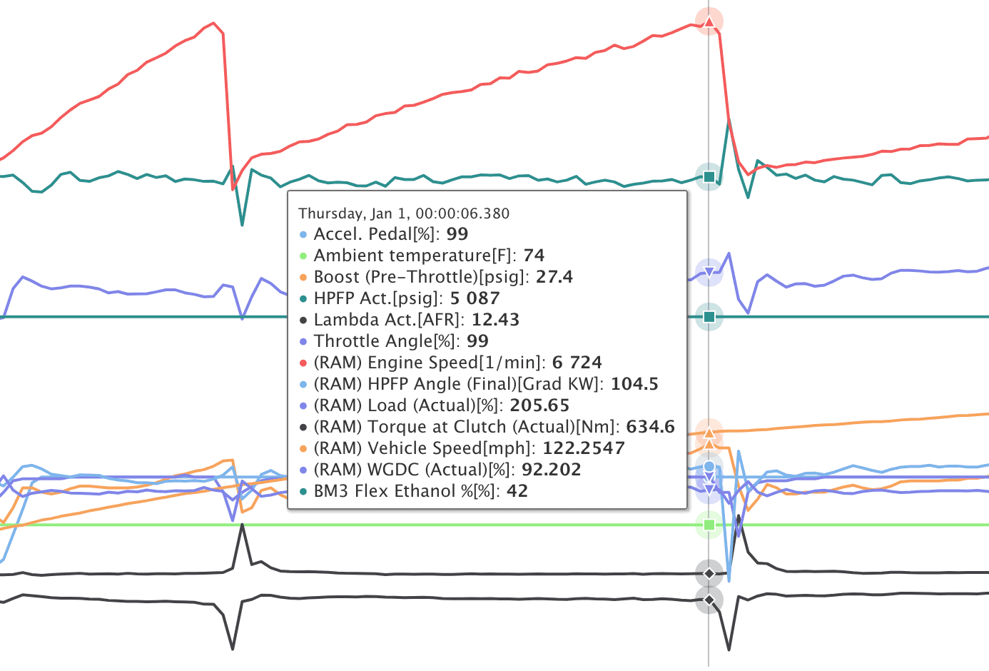

Thinking about bumping up to e40 maybe e50 blend is the stock fuel system enough to handle it?
Yes, with no issue as long as you are smart about the boost curve tuning.
Here is my personal Supra with a Pure 700, E42 in this log and almost 28 psi out the top.
I have run up to E45, in warmer weather, the HPFP angle gets closer to maxing out at 126* but usually it's around 105-115*. 104* here in this log point
Damn 27 psi at redline, she is cookin:cool:
I was thinking these settings for @Phantomx. Small steps at a time as WGDC is already >90. Not much more boost to be had 6k+ on baby stock turbo.
