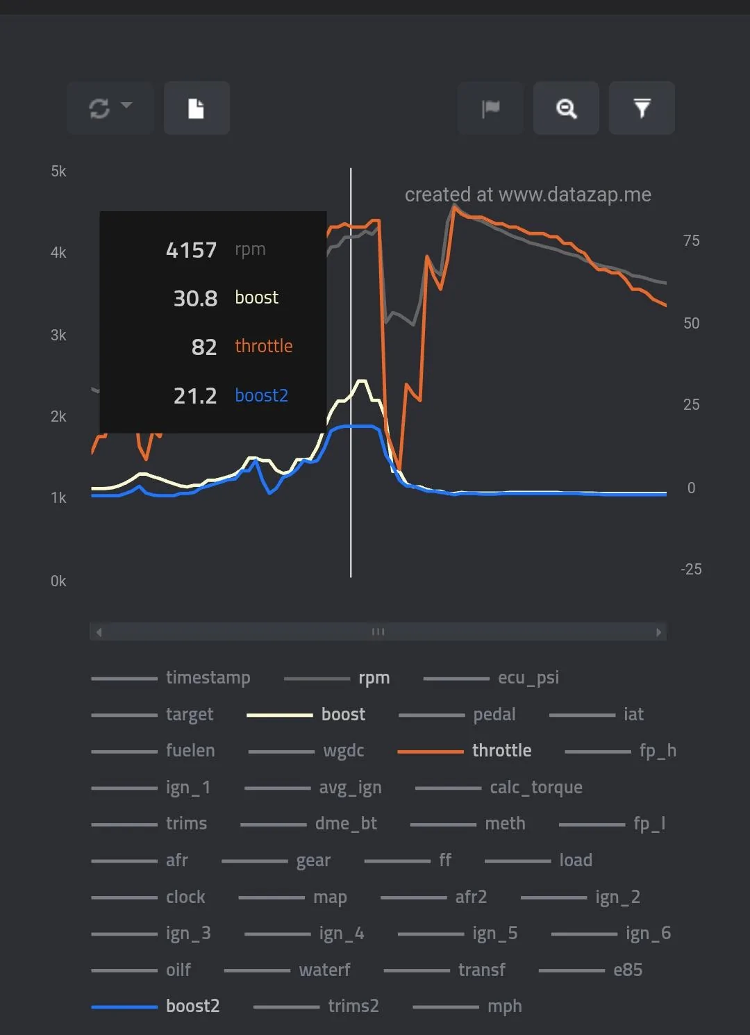

This is what I’m referring to
https://datazap.me/u/phantomx2k/bef-map5?log=0&data=1-4
This is not safe 35psi boost 21 psi boost2 part throttle just trying to pull out in traffic
Gotcha yes, now I can see the problem. I will get a closer look soon.
Make sure to send this log to Terry too.
Your engine is fine, throttle did its job.
@Jesse DaBears hard to argue with that. BEF definitely has partial pedal issues. I guess wide open works fine. Can't imagine what in the BEF would provoke it to go full wastegate closed at partial load 🤷‍♂️

HUGE THANK YOU to Terry at Burger
HUGE Shout out to Javi at Midnite Motorsports we did so many damn runs and logs today and he was awesome! Highly recommend.
I sent Terry a frantic message about the boost spike and we ended spending an hour on email going back and forth troubleshooting. There was a lot of flashes, reflashes, logs, etc.
Turns out there was an issue in The BEF Terry had to reverse the throttle change table and he sent me a new BEF and that cleared up all the weird stuff with drive ability and over boosting/spikes. THANK YOU TERRY!!!
