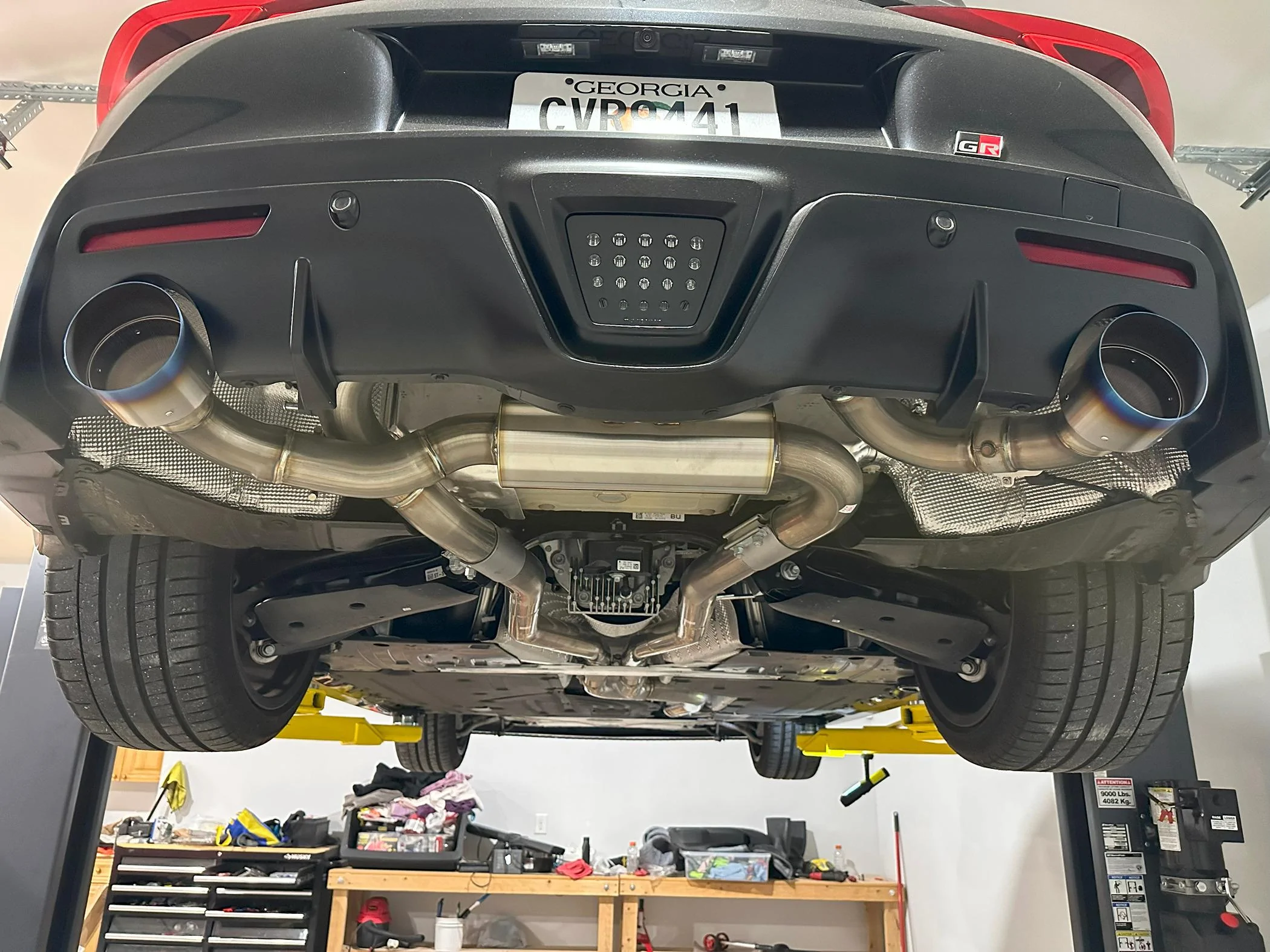

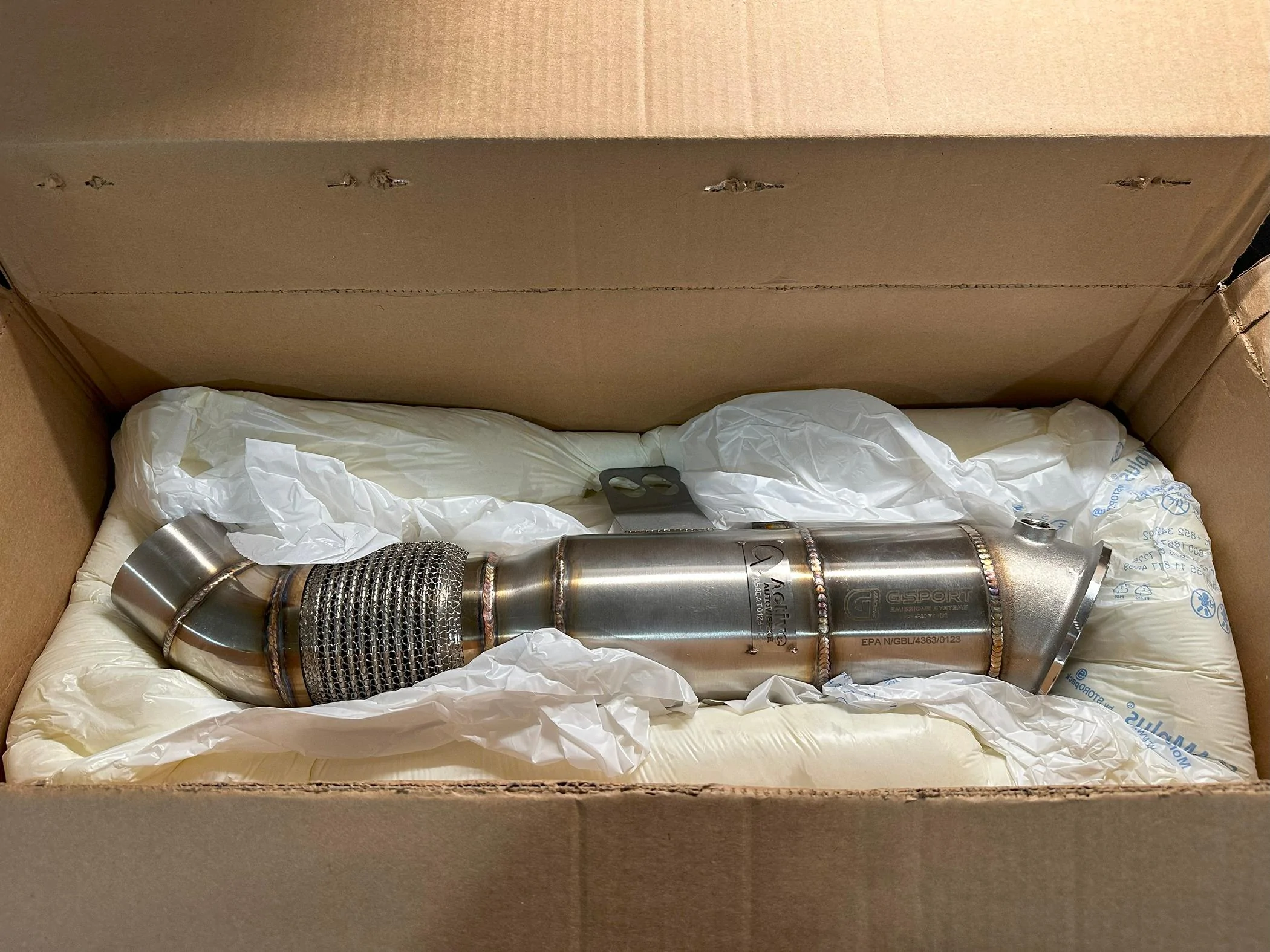

Hi Shaloot,
Happy to share my experience. Here is the list of performance mods I've done:
DME Femto unlocked via Euro Performance Center
Bootmod3 (BM3) OTS tune, Stage 2
Active Autowerke Catted Downpipe- GR Supra 20+
HKS DUAL MUFFLER for 2020+ TOYOTA SUPRA GR MKV A90 / A91
HKS Cold Air Intake Full Kit MKV Supra GR A90 / A91
According to BM3 this should be a 500-550HP build. I haven't had the car dynoed, but my "butt dyno" says that is pretty close. The car is significantly faster and more powerful. Really it feels just right, like the car should have came from the factory.
Almost everything works great. Engine runs smooth but is just so much more powerful. I've only encountered a couple of minor issues:
- The traction control doesn't work as well, as it wasn't designed for this power level. It actually feels easier to control from a dig without the traction control on now. With traction control on it feels like the car is fighting itself a bit, and getting more sideways at times.
- Every once in a while if I launch really hard I feel as though the clutch slips a little bit. So this setup feels like it's at the upper limit of what should be done on the stock clutch without upgrading. My plan has been to upgrade the clutch if/when this one wears out.
Hope that is helpful!

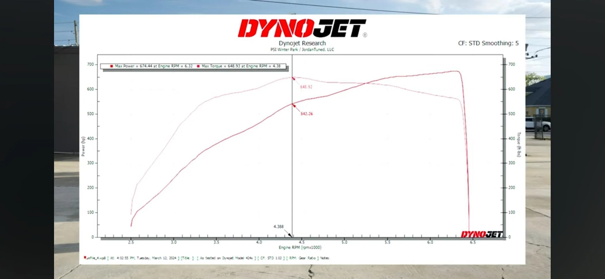

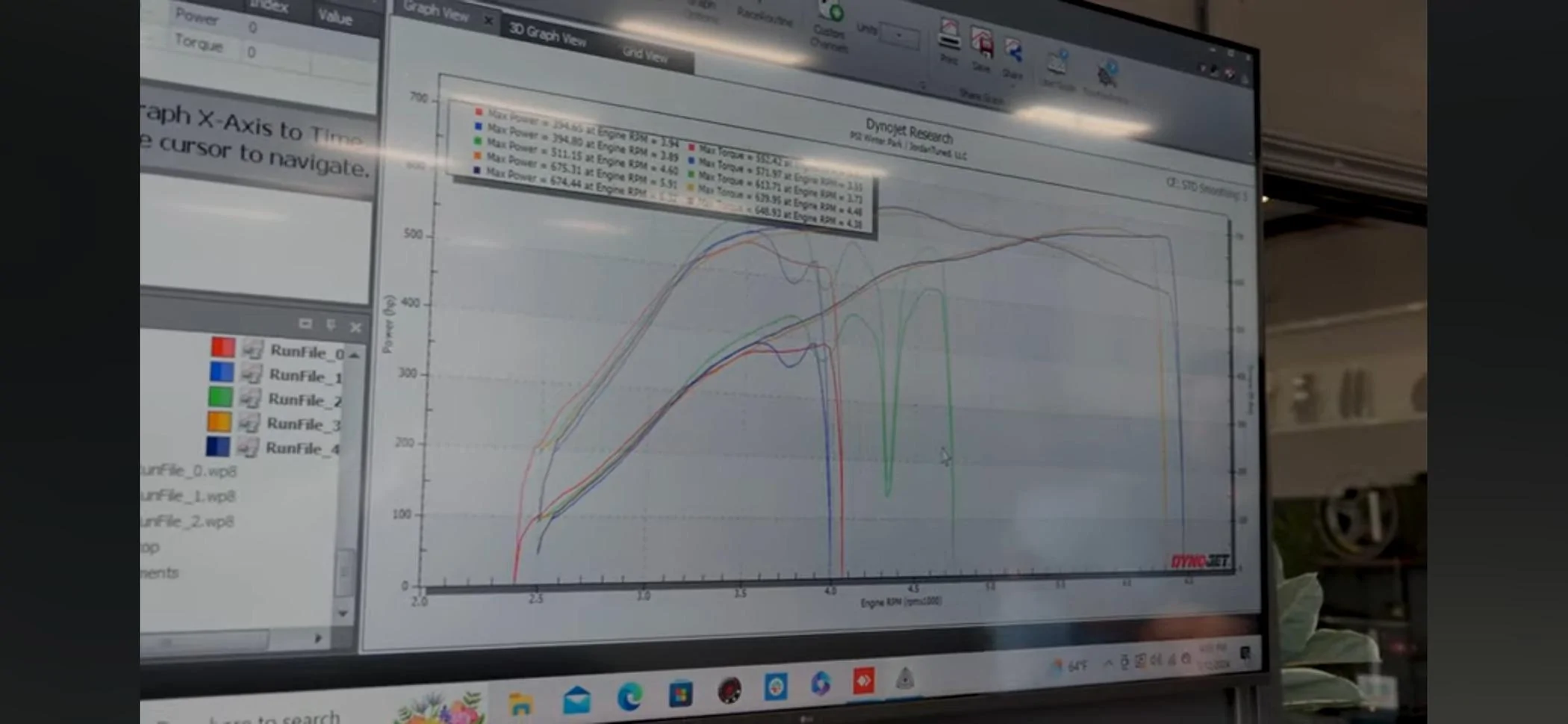

Saw this the other day. Another data point for the 6MT folks. Comparing an s58 xdrive M3 to a 6MT Supra.
2:22 dyno strap down
4:34 recap
Supra reported to have Pure 800, meth injection, etc, not clear what exact fuel was used, what platform or engine management was used, what gear they did pulls in, what ambient conditions were etc car looked a little sloppy first couple pulls based on graph and the car bucking on the dyno. They claim dyno jet wheel numbers:
674 hp
648 ft-lb ("more than we'd like", "stock clutch... Last one to two weeks" 😂 😂 😂 )
And "potential" (not sure where he came up with this) for 750/750 with a clutch upgrade. Don't know how credible this person or shop is. They sell supra parts:
https://precision-sport.com/collections/supra-build-products
I believe the tuner is Cary Jordan, and there is a thread in this forum about them.
https://www.jordan-tuned.com/

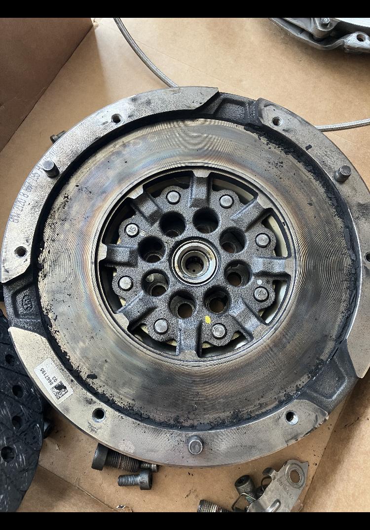

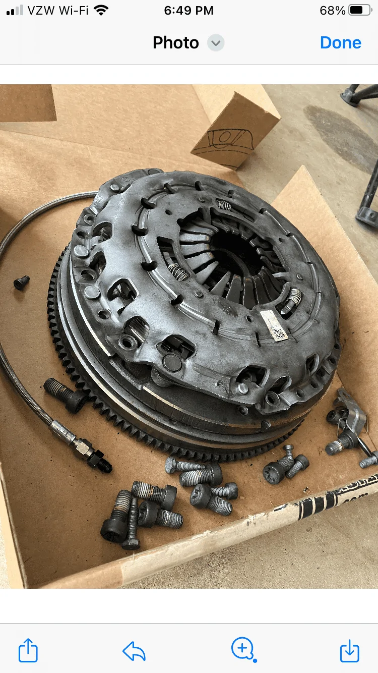

How's the stock clutch holding up?
DGINR8supra
Matt
Jan 22, 2023
64
91
East Coast
2023 Toyota Supra
It held up to e40 for awhile, noticed slipping on the first pull on e50 meth so I was cautious with it. Definitely some material on the flywheel you can see in the picture. Like night and day from stock clutch to fx1000. That’s how the car should of came from the factory.
