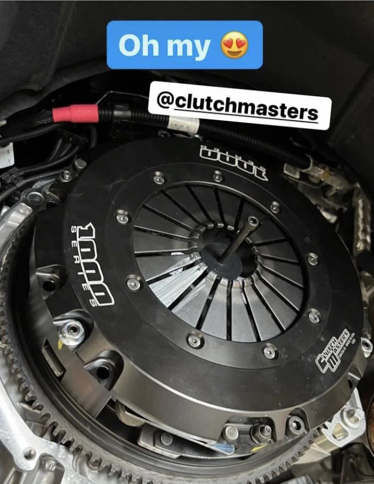

Do you have the stock flywheel? How is the pedal feel?
It came with an aluminum flywheel, Pedal feel started out stiff but was progressive and predictable. Friction point is high. Effort is approx 2 x stock clutch effort so far but it's getting lighter.
TBH shifting feels better with crisp engagement and no CDV nonsense, Downshifts grab instantly where as stock clutch felt like it didnt.
My setup is:
- 1000 series twin disc clutch with aluminum flywheel - link
- Hydraulic release bearing - Link
- Clutch pedal bushing and pin kit - Link
- Redline 75-140 gear oil to reduce chatter

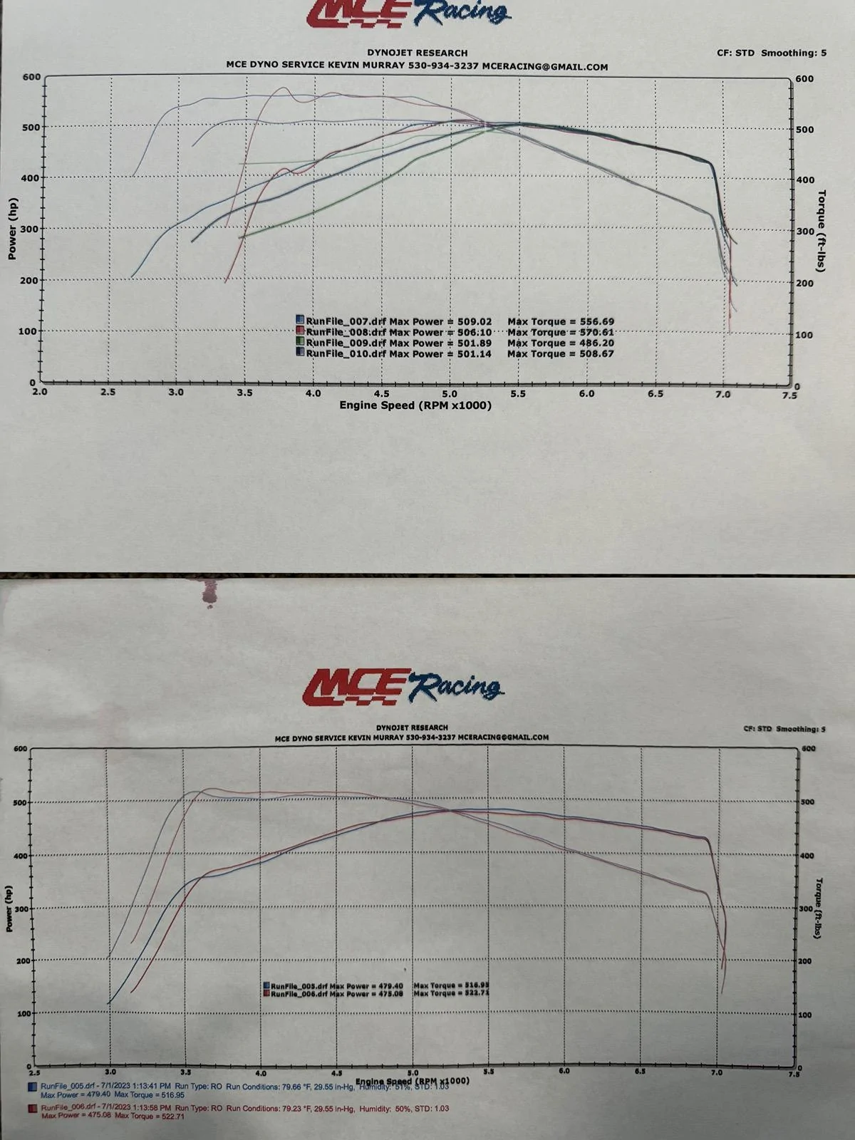

Well since this thread seems to be revived I’ll add to it to help my manual brothers out.
Top dyno sheet was on a custom e50 tune. Run 1 & run 2 was just a custom e50 tune. Run 3 & run 4 I added some VP Racing octane booster not tuned for it.
Bottom dyno sheet was MHD OTS e40 map. All in all, I gained about 30whp/48wtq.
Can’t say enough good things about this clutch. It’s awesome
Can’t wait to get this. Simply just waiting for my clutch to go out or once I feel the need for more power, but the clutch so far has been holding up fine.

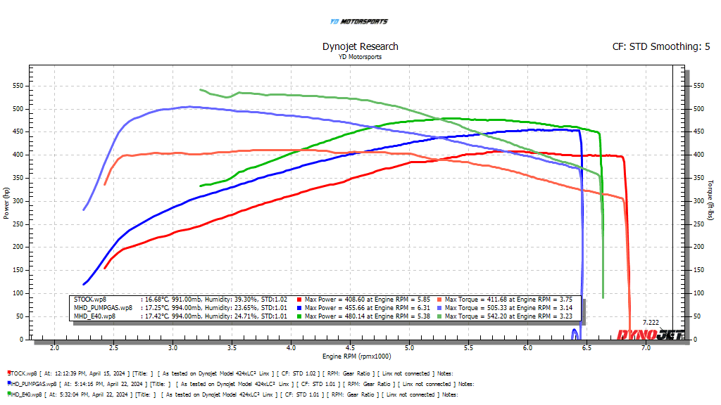

Another datapoint for the MT gang. MHD+ OTS e40 and 93 compared to stock.
Car has a catless downpipe, and BMC drop-in filter.
