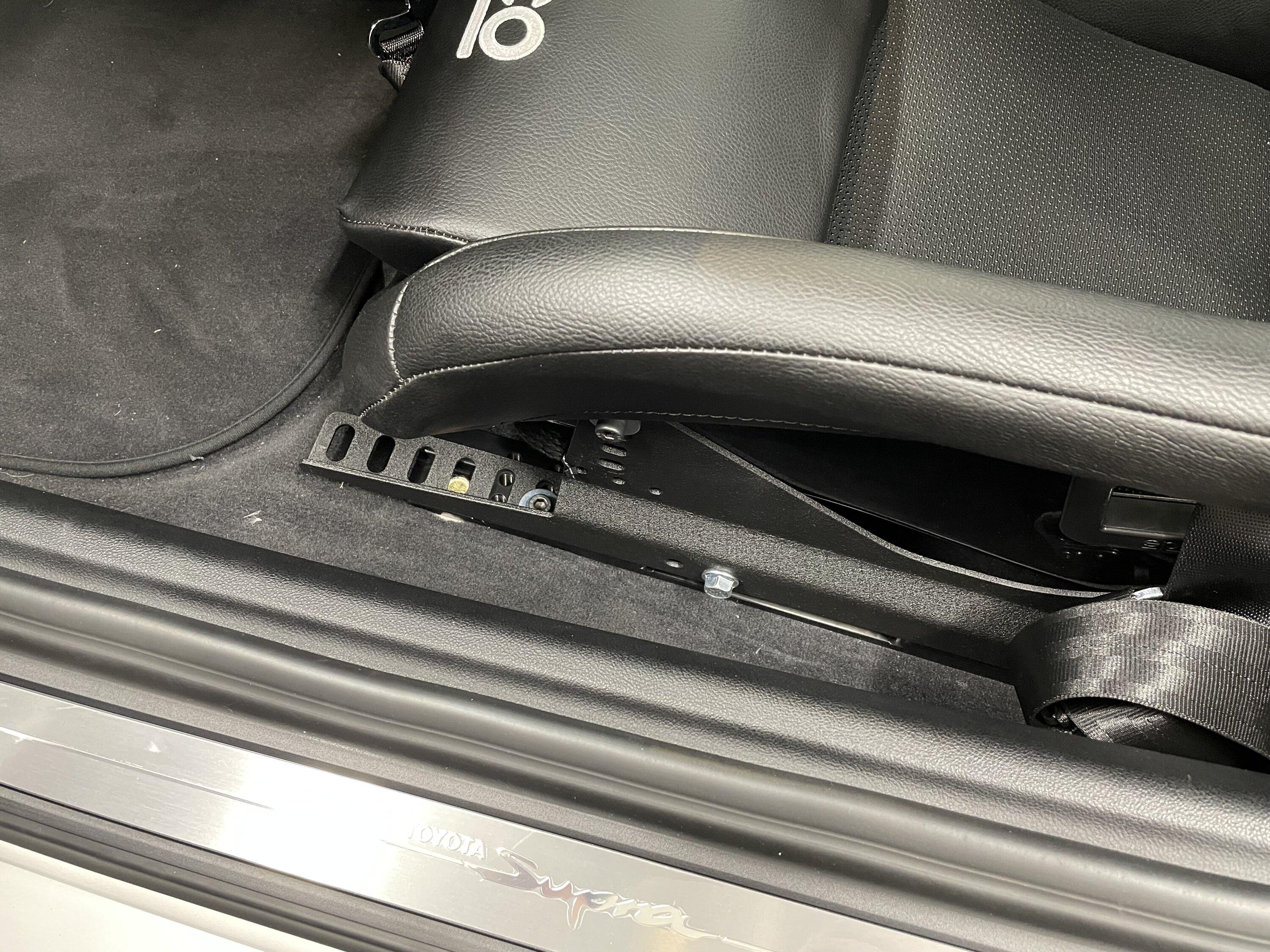

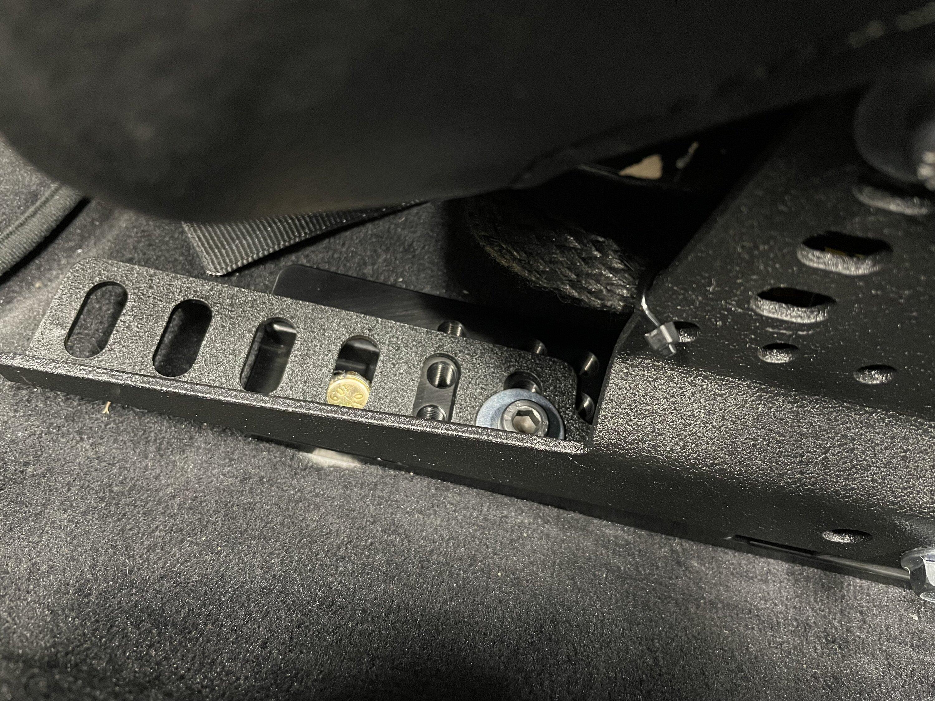

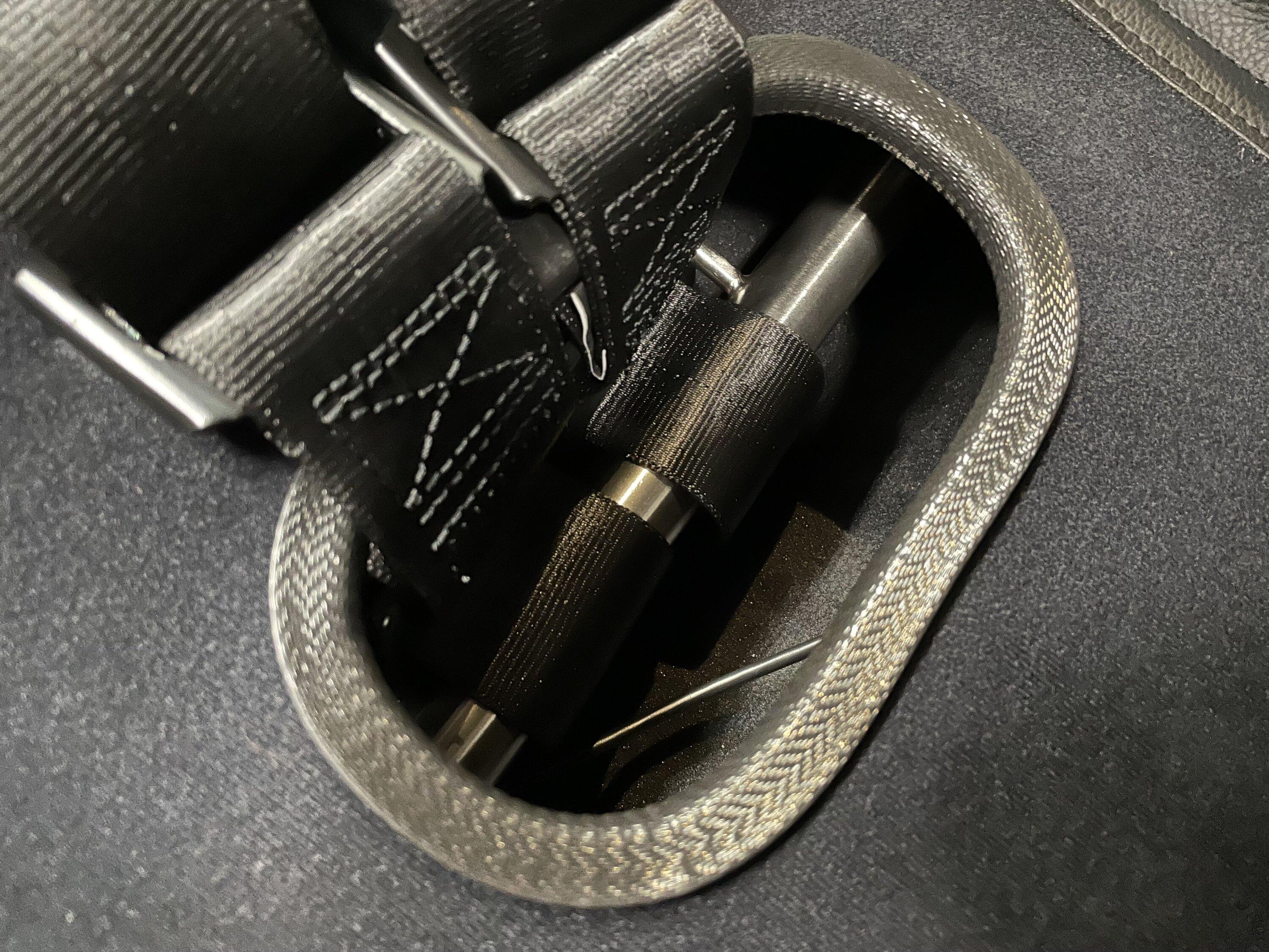

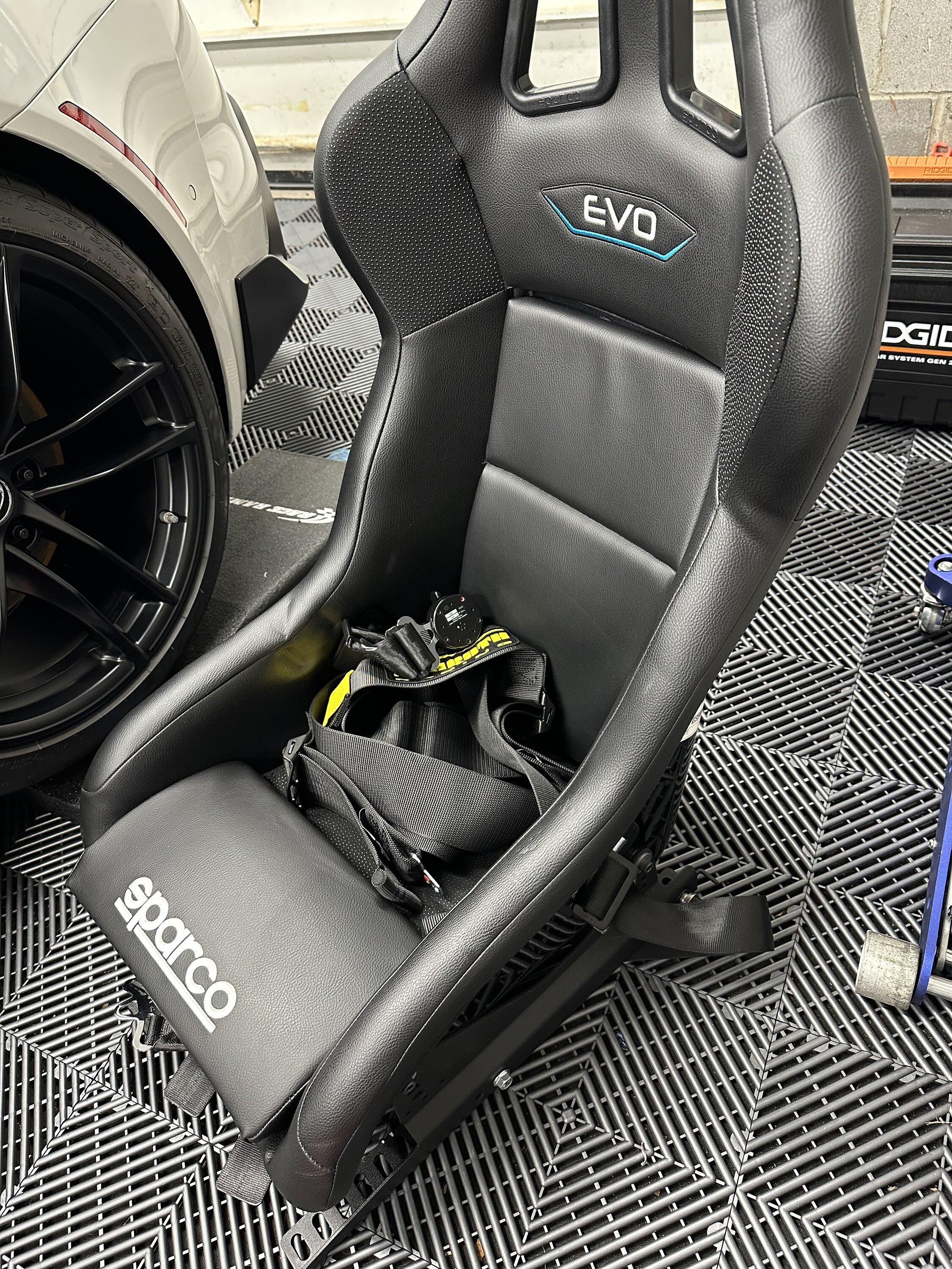

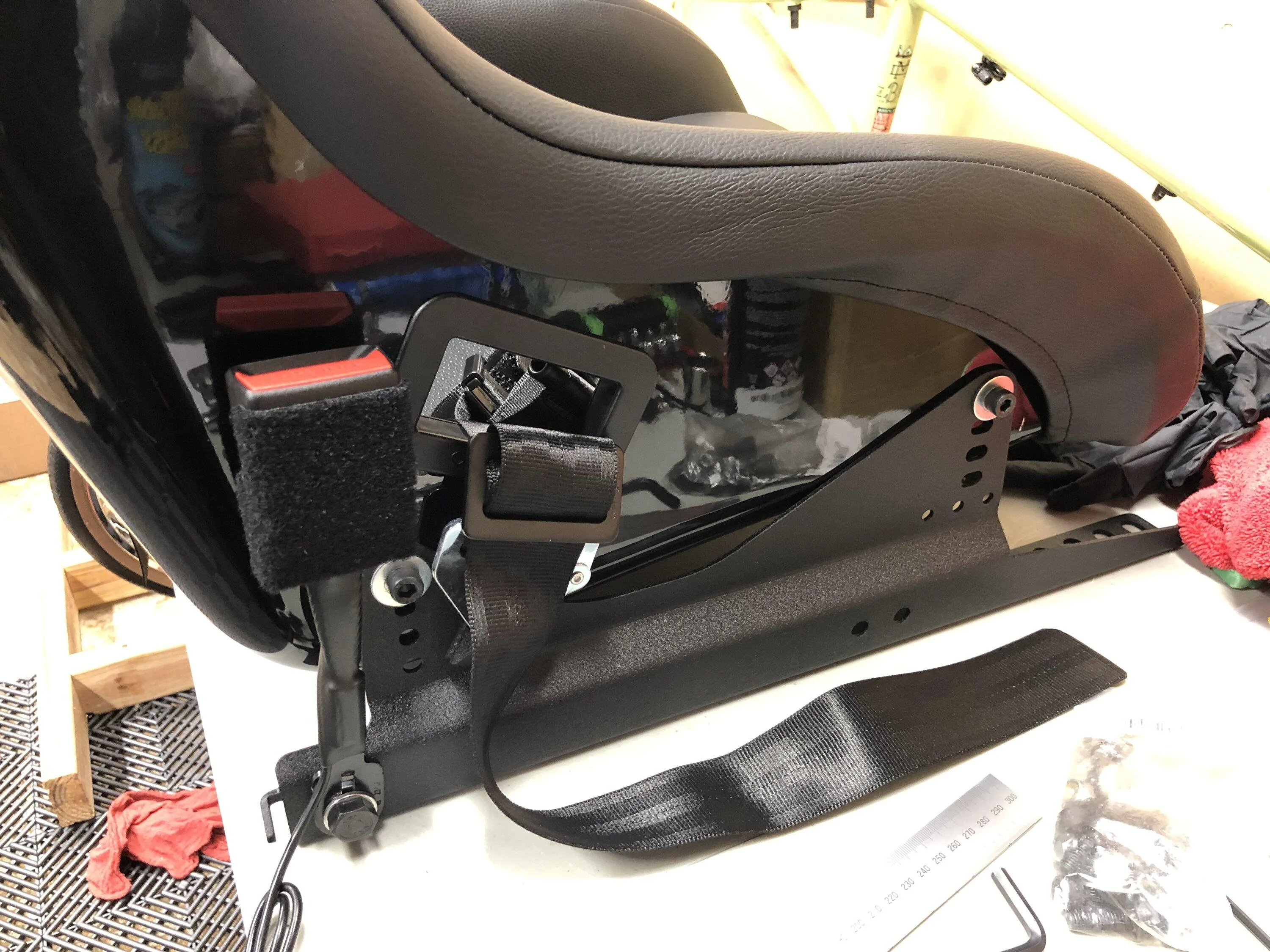

The Brey Krause side mounts bolt straight to the floor. Also have a nice six point addition that you can purchase separately.
Here is my setup. Straight to the floor was a little too low for me (i'm around 5'9") so I purchased Macht Schnell floor mounts to raise the seat a little.
https://www.bkauto.com/R_9261_for_Mid_Width_Seats_p/r-9261.htm
https://www.bkauto.com/R_9258_Sub_Strap_Mount_for_BK_Side_Mount_System_p/r-9258.htm
https://machtschnell.com/competition-liteweight-floor-mounts-for-racing-seats-e8x-e9x-f8x-m3-m4.html

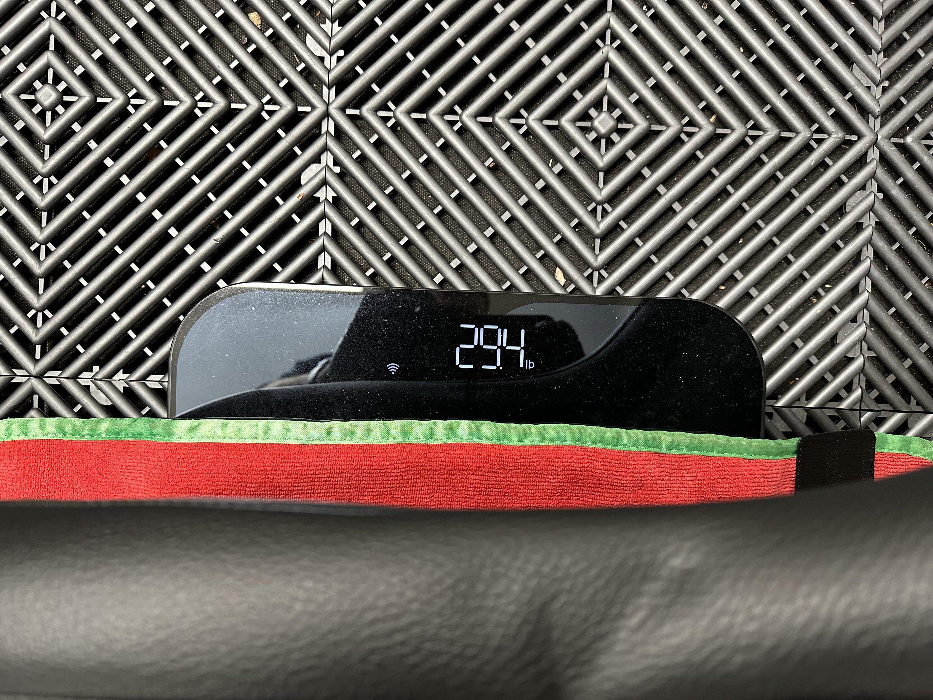

@razorlab do those BK floor/side mounts really only weight 4.5lb per seat?
(Iā€™m assuming you weighed them in the name of data haha)
LOL. Not by themselves but I did weigh the seat + 6pt harness + side mounts + 6pt bar + Oem seat belt buckle.
Sparco Evo QRT is advertised at 15.5lbs itself
