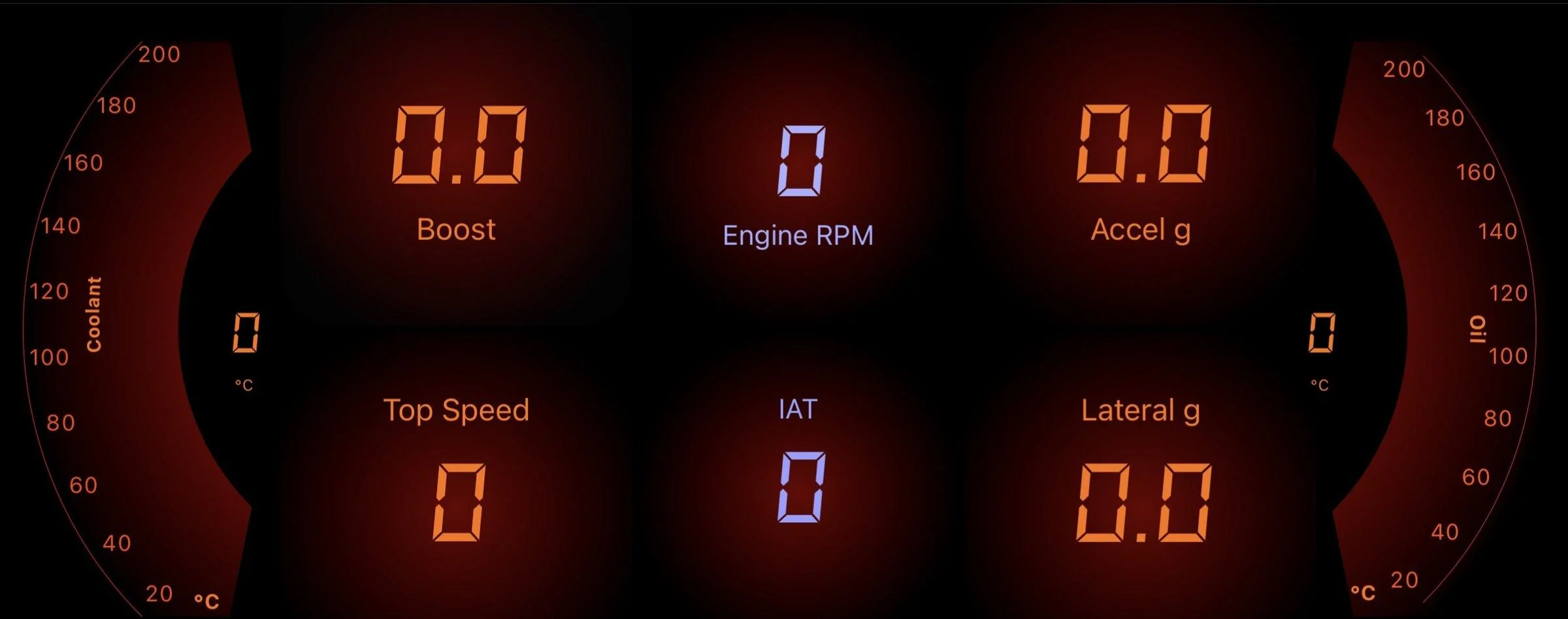

I wanted to share my setup and how to easily create gauges that match the Supra's gauges and lighting somewhat closely. Even if you don't use my settings, hopefully this write-up will help some people with creating displays which are helpful to them.
This is my "Dashboard" for reference:

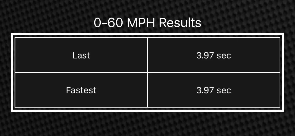

By the way, this app also has a performance mode for 0-60, 1/8 mile, 1/4 mile, 60 foot, etc. readings. I don't know how accurate these are but they can be fun to try out :) This was my first attempt at using the app for this purpose in -1' C (30F). Not bad for a very cold run on stock tires... I think?

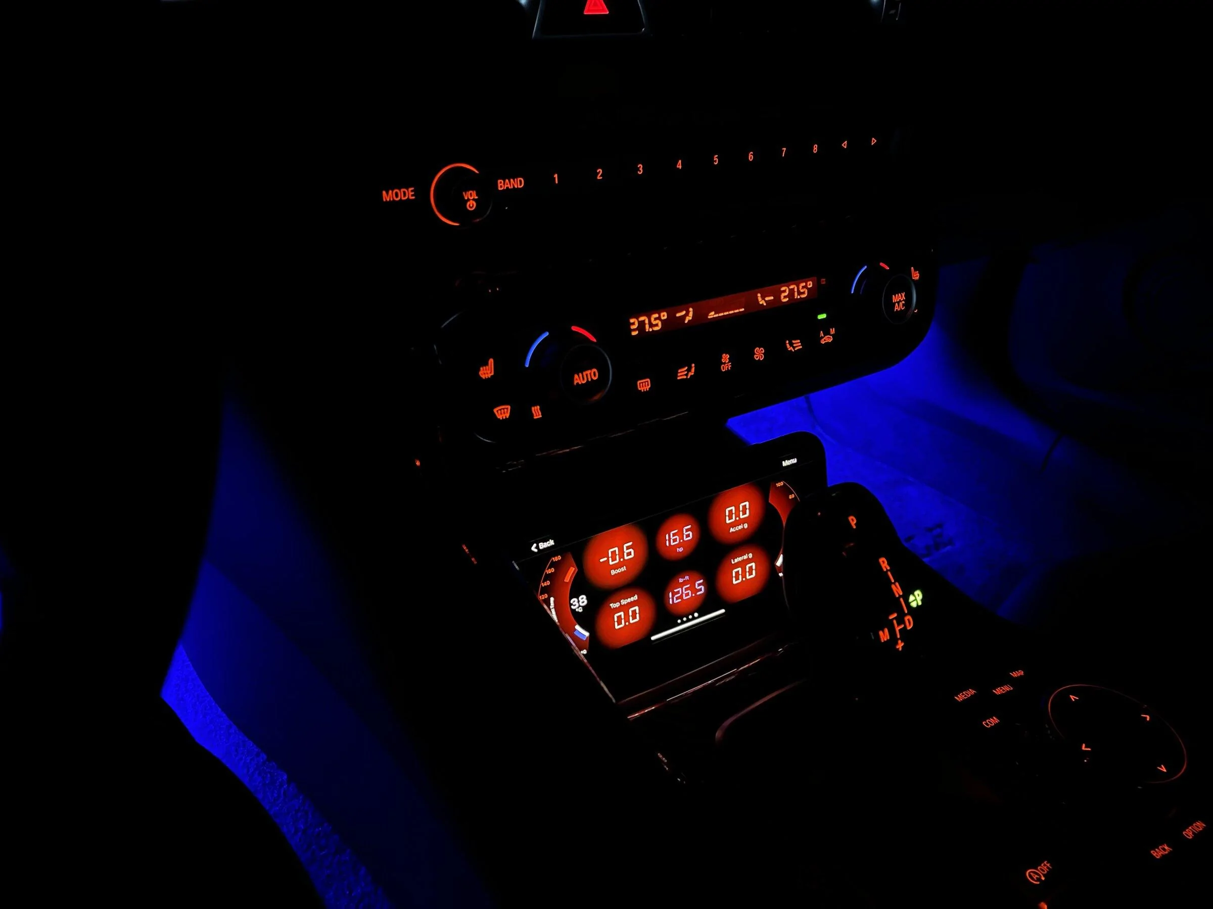

To mount my phone I used this Scosche magnetic mount. It mounts to the cover above the wireless charger and holds the phone securely with no vibrations or rattles (note I'm using an iPhone 11 Pro Max with a case).
MagicMount Car Vent Phone Holder MAGVM2 (scosche.com)
This is an older picture of what the setup looks like - I will try to update this post with a newer picture (using the dashboard I posted above which has colors that better match the Supra's lighting).

Step 1: Create the dashboard and begin adding displays
  • In the Dashboards area of the app, click on "Menu" then "Add Dashboard"
    • You should automatically be brought into your new dashboard. If not, swipe the screen to the left until you reach your blank dashboard
  • Click "Menu" and then "Add Display"
Below I will explain how I created my dashboard. After you select your gauge type, the "PID" area of "Display Configuration" is where you will select what sensor information you are trying to display (RPM, Boost, Temperatures, etc.). Depending on what you are displaying, you may want to change the "Number of Decimals" (for example: boost is good with one decimal, temperature/RPM are probably best with Zero).
All of this can be edited after you have created a display in the "Display Configuration" tab so you don't have to go through the whole process of adding a display if you decide to change from one PID to another.
After you edit the settings in each gauge type but while still in the editing screen, go back into the "Style" tab, click "Menu" and then "Save Template." The next time you create a digital gauge, finish creating it (in any of the default styles), then you can go to the menu and load the template and all the settings should transfer to this new gauge. You will need to this for three different gauges which I have listed below.
1: Inside digital gauges (boost, speed, rpm, etc.)
Display type:
Digital Gauge
In the "Size and Location" tab:
  • Height 55
  • Width 33
In the "Style" tab:
In the "frame" sub-tab:
Background color:
  • Inner Color: ff660000
  • Outer Color: ff030303
  • Gradient Radius: 0.55
  • Inner Color: 00000000
  • Outer Color: 00000000
  • Back Gradient Radius: 0.55
Bevel:
  • Width: 0
  • Flatness: 0
  • Color 1/2: these won't matter
Title label:
  • Color: FFFB7200
  • Font scale: 0.085
  • Position: 0.698
Value Label:
  • Value Color: FFFB7200
  • Font Scale: 0.34
  • Position: 0.423
Units Label:
  • Font Scale: 0.02 (all the way down) but if you would rather see the units, use the same color from the previous values (FFFB7200) as this matches the interior lighting fairly well (although keep in mind I am pretty colorblind)
Glass Effect:
  • Disabled
I used this template for the all of the inside gauges. For the smaller gauges (RPM and IAT) I change the size to 50 height and changed the Title Label Color and Value Label Color to FFA7ABFF. I may change them back to FFFB7200 to keep them all the same.
2: Outside Arc Gauges (there are actually two separate things happening for these gauges):
2a - First the main gauge:
Add an Arc Gauge:
Position Left
  • Height: 90
  • Width: 33
  • Top: 5
  • Left: 3.895089
In the "Display Configuration" tab:
If you are using these gauges for engine and coolant temperatures, I changed the "Range" values to:
  • Min: 20
  • Max: 200
In the "Style" tab:
In the "Frame" sub-tab:
Location: Left (after you create another template for this gauge, all you should need to do is change this to right for the gauge on the right side)
Background Color
  • Inner Color: FFDF0000
  • Outer Color: FF0A0000
  • Gradient Radius: 0.675
Bevel
  • Width: 0 (this should be the only setting that matters here)
Title Label:
  • Title Color: FFFB7200
  • Font Scale: 0.032
  • Position: -0.026
  • Horizontal Position: 0.04
Value Label:
  • Value Visible: disabled
Units Label:
  • Color: FFFB7200
  • Font Scale: 0.035
  • Vertical Position: 0.075
In the "Axis" sub-tab:
Major Ticks
  • Width 0
  • Length 0
Minor Ticks
  • Width 0
  • Length 0
Labels
  • Visible: yes
  • Rotate: no
  • Color: FF24402
  • Font Scale: 0.038
  • Offset From Tickline: -0.025
Baseline
  • Position: 1
  • Width: 0.573
  • Color: FFF50404
In the "Range" sub-tab:
Fill:
  • Enabled: yes
  • Inner Position: 0.632
  • Outer Position: 0.664
  • Color: FFFB7200
  • Border Width: 0
Range Appearance:
  • Inner Position: 0.67
  • Outer Position: 0.72
  • Border Width: 0
2b - Now temperature gauge to match the inner gauges:
Add a digital gauge
  • Height: 28
  • Width: 33
  • Top: 35
  • Left: 0.9737723
  • Delete the title
In the "Style" tab:
Background color:
  • Inner Color: FF000000
  • Outer Color: FF000000
Bevel:
  • Width: 0
Title Label
  • n/a
Value Label
  • Font Scale: 0.34
  • Position: 0.42
Units Label
  • Font Scale: 0.085
  • Position: 0.8
Glass Effect:
  • Disabled
After all of this is done, you will have to move the gauges to where you would like them. To do this, tap and hold a display for a couple of seconds. A menu will pop up - scroll down to "Drag and Move." This will allow you to place the displays where you would like them.
If you forgot to save a template, tap and hold the display, click on "Style" then click on "Menu" and you can save the template at any time. This is also helpful if you decided to change a display to something that better fits your preferences. You can then click and hold any previously made display, open the "Menu" in the "Style" tab and then load the template into the old gauge so it matches your changes.
I hope this was helpful! Good luck and I would love to see what kinds of "dashboards" anyone may create with this app!

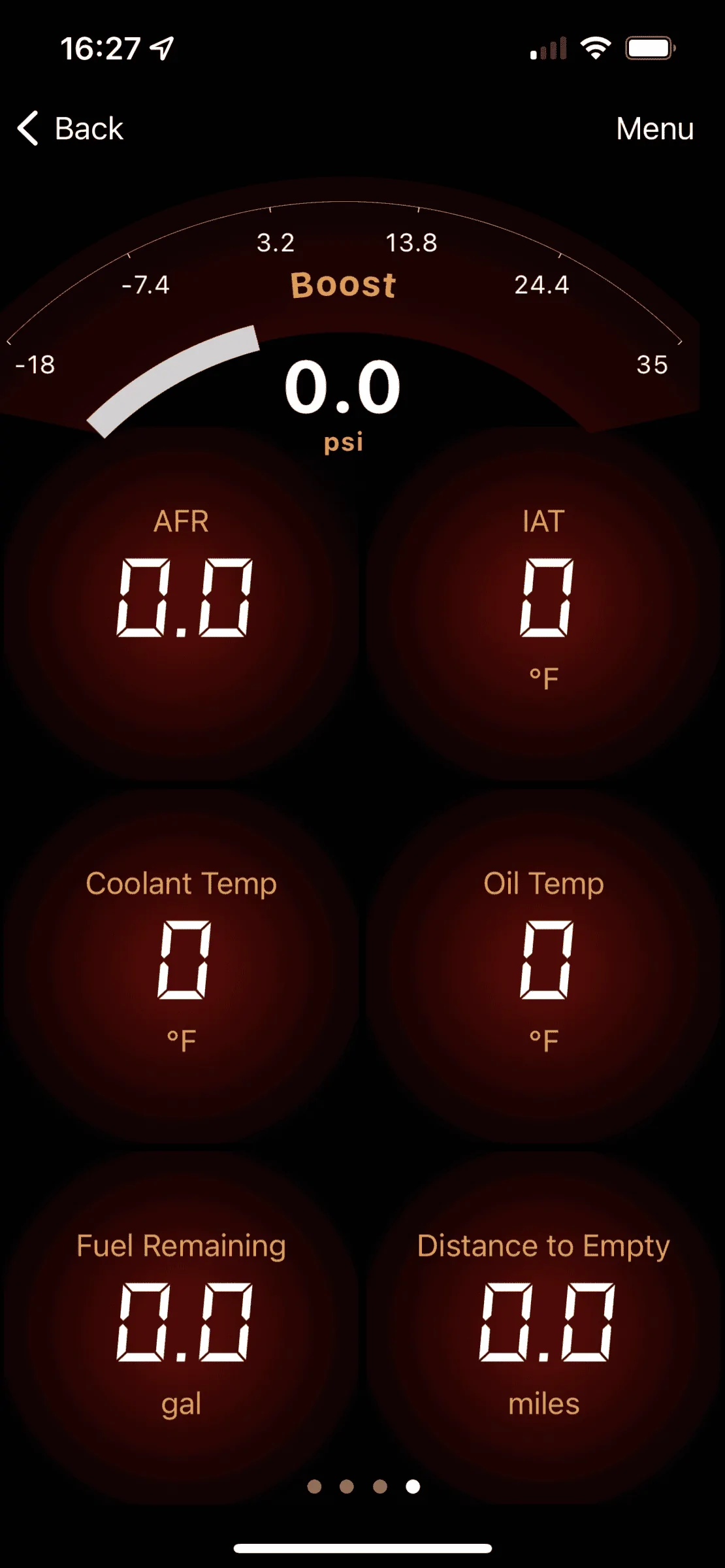

Thanks for the write up. I built a little dashboard based on your style that I’ll likely refine (style and PIDs) over time. I went with white metrics to match the white in the dash.
I went with:
  • Boost
  • AFR
  • IAT
  • Coolant Temp
  • Oil Temp
  • Fuel remaining and distance to empty (only because the reading in the dash always seems to revert to the odometer)
I would have liked to have knock values/average, but I couldn’t seem to find it. I may see if there’s an exhaust gas temp sensor somewhere pre cat as I’ll have a catted downpipe, and someone said to be mindful of that as I move up in power levels.

Nice - I love the boost gauge at the top!
Looks awesome!

Update: I found the refresh rate on these gauges to be incredibly slow. I'm sure it's fine for things like temps, but it was unusable for me for anything that required real time feedback like boost and AFR.
Anybody else have a similar or different experience?
It was refreshing <= 1 time a second.
