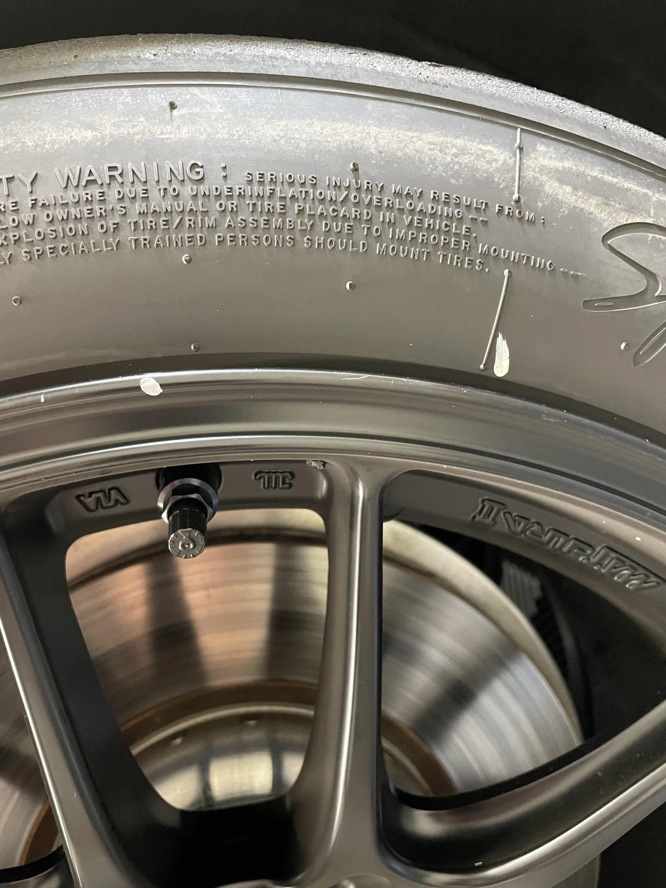

Does anyone have a pic of the black sensors/valvestems on their wheels? Would be interested to see how they look vs. silver lol.

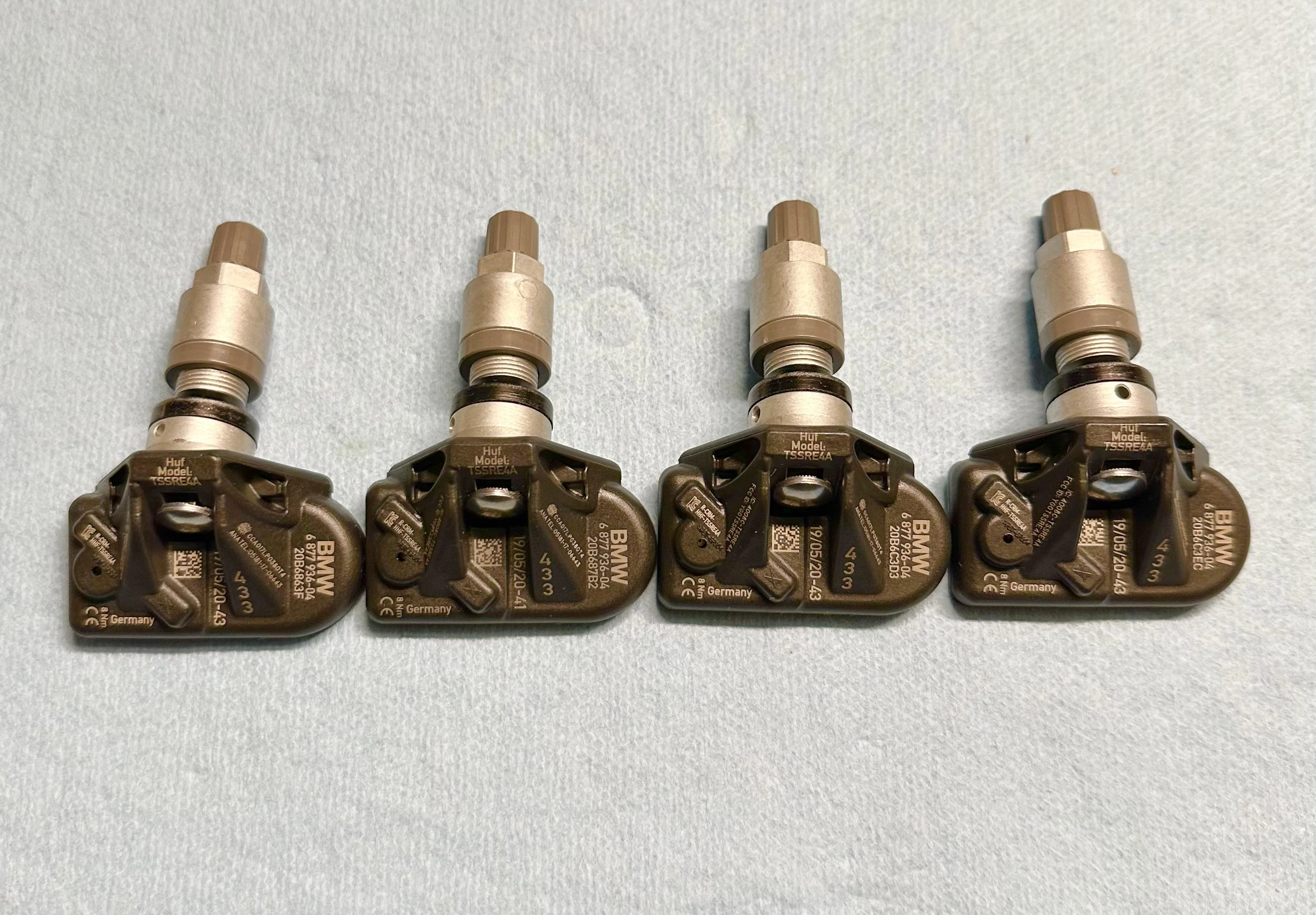

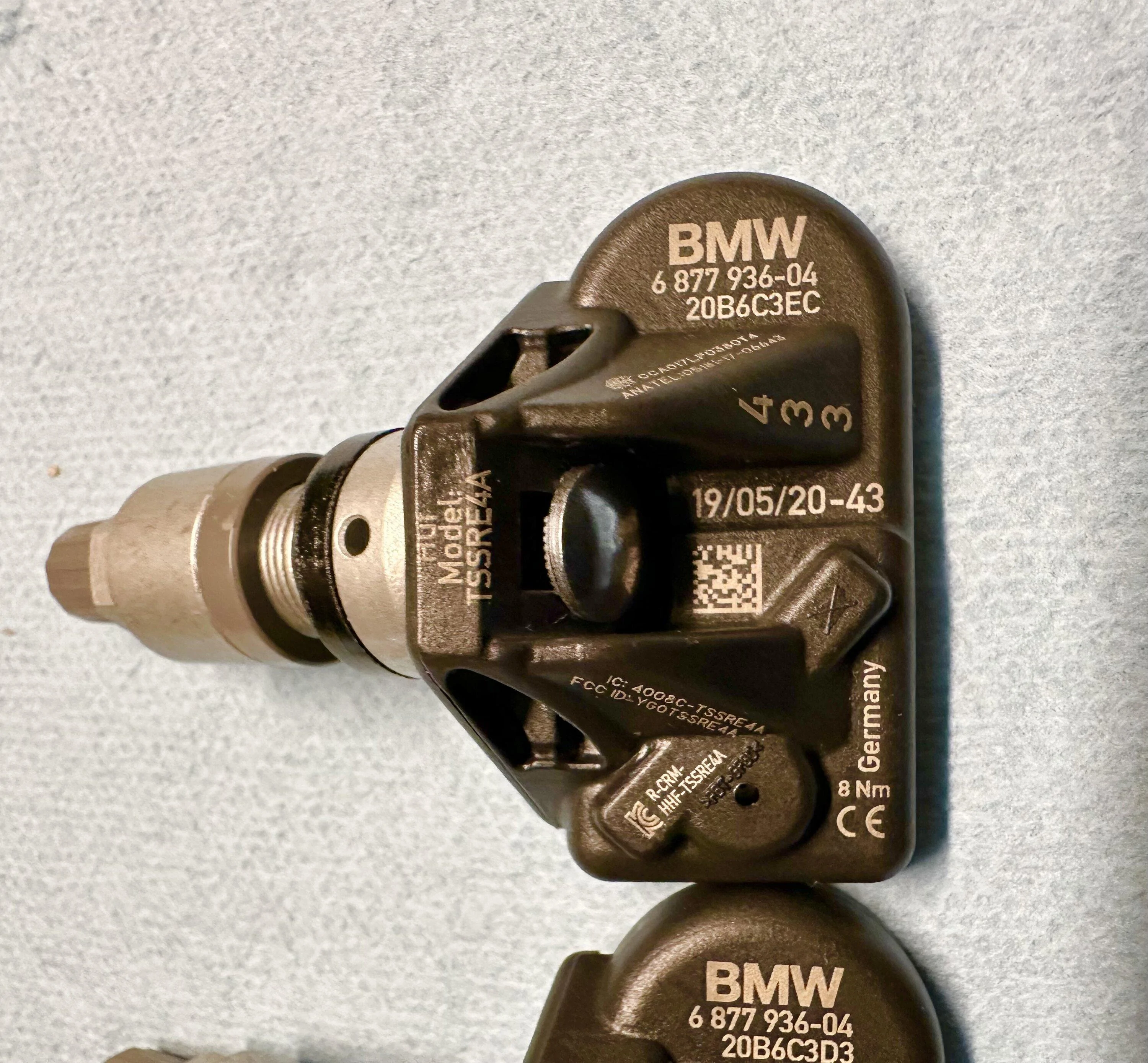

So the OEM TPMS Sensors have gone up in price six-fold :mad:. I had previously paid $20.98/sensor and they are now $127.31/sensor. I beleive the 2023 cars need the Toyota 42607-WAA02 Sensors which are the 433MHz sensors. If that's the case can anyone confirm these will work? I've got another set of wheels so I need another set of sensors.
Huf IntellSens TPMS Sensor - Fits 2020 - 2022 Toyota Supra GR 42607-WWA02 433MHz | TPMSDirect
Bit of a thread necro, but wanted to thank you for bringing TPMSDirect to my attention. Much less expensive than the options I was looking at from other vendors. It's nice to have a source for inexpensive TPMS, and I just picked up a pair for my drag pack. ✌

I have a brand-new spare set just sitting here.

Man them are purdy! I ordered TPMS so long ago on eBay from this thread (pages back), for my track set of tires. Damn things still chugging along perfectly.
https://www.ebay.com/itm/2653600316...5wzE6zWSIG&var=&widget_ver=artemis&media=COPY
I was only worried about the megahertz at the time. Didn’t realize stem color 😂 I like the black.
https://www.ebay.com/itm/2660732523...5wzE6zWSIG&var=&widget_ver=artemis&media=COPY
Silver cheaper ☝
